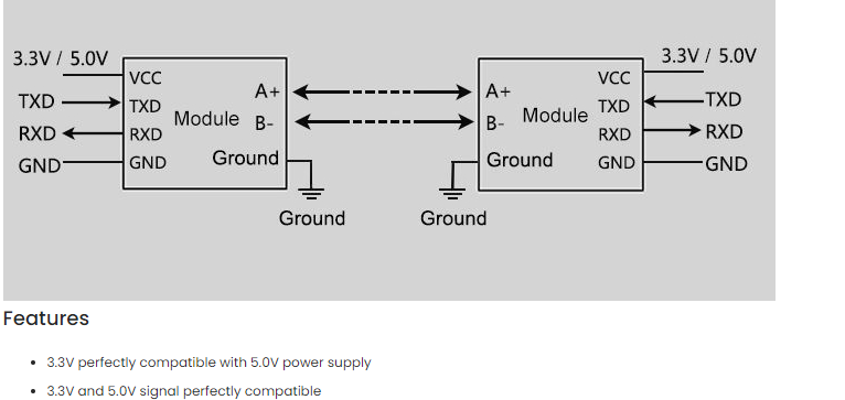

Im working on a Project. I have 1 Wemos D1 (master) and 2 Arduino Uno(slave) and Rs485 modules i shared the image below.
How can i send different integers to different arduinos ? Are there any example about this ? I have really hard times to doing this.

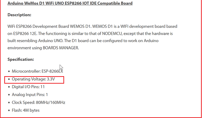

To start, check the datasheet of your RS485 module, does it run on 5V standard (as MAX485) or 3.3V? Then do the seme for your D1. Incompatible voltage levels between the 2 are not good.
It runs on 5V as MAX485.
And your D1 ...
I read the topic but you mentioned RE and DE connections and i dont have this connections in my board as you can see. Im really new person who started to coding arduino and other stuff. Already finished some project but this communication style is very new for me. And what i have as RS485 is different than other topics other RS485 to TTL. So i dont have RE DE pins and im confuse.
It looks like your board is one of those that automatically switches from receive to transmit mode and then back again. You can ignore and mention of the RE & DE signals as they are for the more common boards that let you control the transceivers directly.
