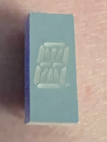

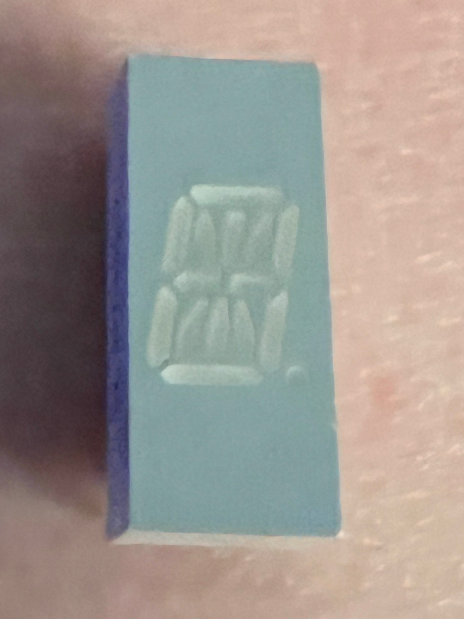

I want to run 12 of 14-segment single display common anode with Nano. I have s HT16K33, but I don't know how to wire or connect them to the Nano. Someone said it will not work with the common anode, so only use the common cathode. Can we use HT16K33 with the common anode 14-segment single display? if not, which driver should we use? Also, someone said it will not work with Nano because it is not fast enough. Use ESP32.

I have 12 of 14-segment single display common anode. See the picture.
I want to run 12 of them. I have Google and still no luck. Someone said we can not use HT16K33 with common anode LED segment. So I am very confused.
You can not use your 14 segment common anode with the the HT16K33.
You could use it for 7 segments. But if you just would need 7 segments you could use a more appropriate 7 segment driver IC for common anode LEDs also.
Supply a link to the data sheet or say what part number appears on the display devices. You could be lucky that there are two separate anodes per device, with around half of the segments allocated to each.

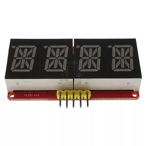

For my TM16xx library I added support for the TM1640 with 14seg+DP CA displays.
I also added support for the QYF-0231 module with HT16K33 that is pictured above (4 digits 14-segment HT16K33 (VK16H33) Backpack, 0.54" 14SEG+DP LED, no buttons, I2C default address 0x70). If I remember well that display is CA.
