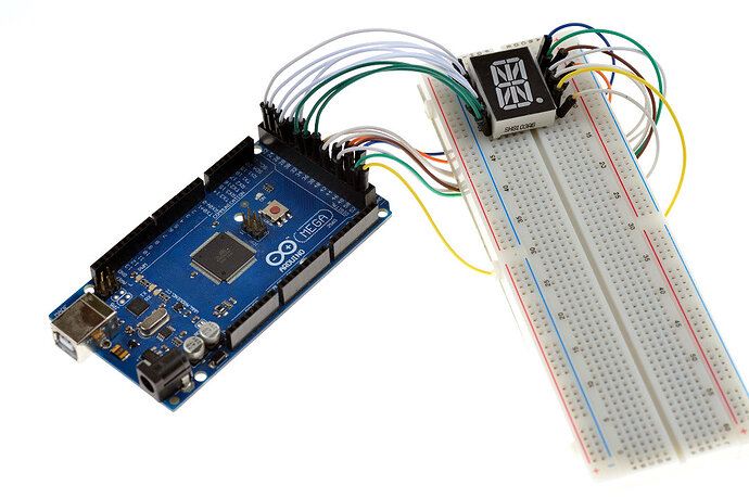

Hi guys,
I'm currently using a bunch of MAX7219 to control 7 segment displays.
However now I'm in the need of controlling 16 segments displays, and the amount of displays I need makes sticking to MAX7219 a bit messy (30x 7 digits in total)
So here's my question: how hard would it be to use the HT16K33 with common anode displays ?
After a bit of research, I figured out it wasn't impossible but would require a different approach code-wise - and that's the tricky bit for me right now. How different would it be ?
I was also thinking that I could potentially use it to manage my 16 segments, using 2 anodes per display each controlling 8 different segments. Can't see why it wouldn't work so far, but I need to figure out the code logic first :smiley:
Thanks, I hope I've been clear enough :slight_smile:

Here's what I think. Please put me straight if I've got this wrong.
7-seg displays: up to 16 digits of either common cathode or common anode can be driven, but not a mix of the two types on the same ht16k33 chip. Using common anode is trickier from a software point of view, because the bits controlling the segments of a single digit will be spread over 8 of the chip's internal registers. So some bit manipulation will be required. For common cathode displays, all 8 bits controlling the 8 segments will be in the same internal register.
16-seg displays: up to 8 "digits" can be used but they must be common cathode. I can't see any easy way to drive common anode 16-seg displays with this chip, except with a lot of extra external circuitry, which I think the OP wants to avoid.
So in summary I would say yes, you can use ht16k33 to drive your common anode 7-seg displays, but your 16-seg displays must be common cathode.

I got a few tips from StackOverflow which helped me figuring out a better way of doing it.
All screens are common cathode (as I had a bunch waiting already), and all plugged to the HT16K33.
The 16 segments displays are connected normally (cathodes on C pins, 16 anodes on A pins), and the 7 segments displays are connected as such:
Digit 1 / Digit 2 : C1.
Segments 1-8 / 8-18: A1-A15.
So basically I'm now able to control 2 (7segments) digits per cathode pin.
I had a bit of a struggle understanding how I could manage them like that, but after a few trials and error which consisted in looping through all segments one by one (shifting bits in loops), I'm now - almost - able to do whatever I want with them.
My problem was that I couldn't see how to control 5x 2digits 7segments and a couple of 16segments at the same time, having only 8 cathodes pins on the HT16K33. The answer is just to plug both digits on on cathode pin, and then manipulate the segments accordingly in the code ...
