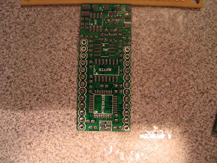

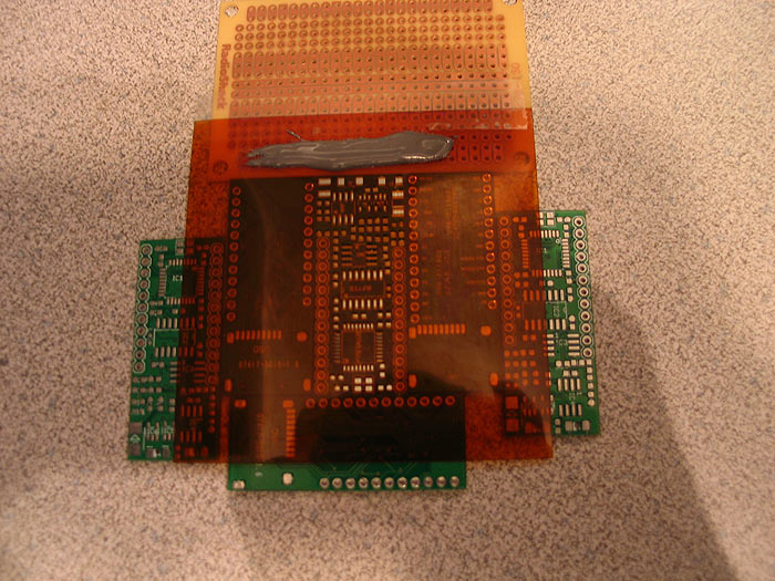

** ^^that coupled with a Silhouette Cameo vinyl cutter.... I have not spent any money on getting stencils made for my project, nor having to have someone else assemble for me either.
Super clean, professional looking boards!!

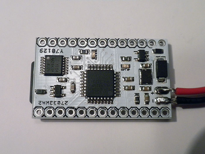

All boards/projects I have made using my cheapier toaster oven:

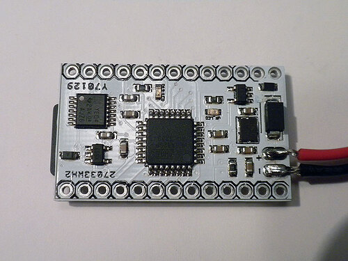

(board on left is custom board, compared to Uno & Shield)

I normally hand-solder 0805 parts and I also have done 0603 parts. They can share each other's pads. An 0805 part on an 0603 pad isn't very happy and it's not a saleable product but it does work. 0603 goes on to 0805 pads nicely.
The images of the part footprints you are seeing in Eagle are just a representation. It's not exactly that size. Just put down the pads in the manufacturer's recommended places and it will totally work. For standard size resistors, there's no need to even check the datasheets.
