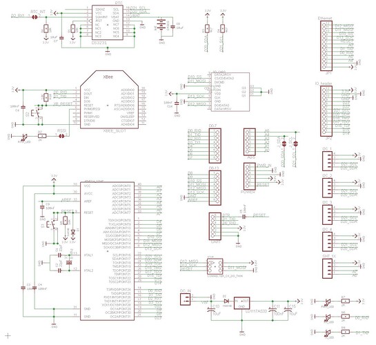

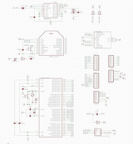

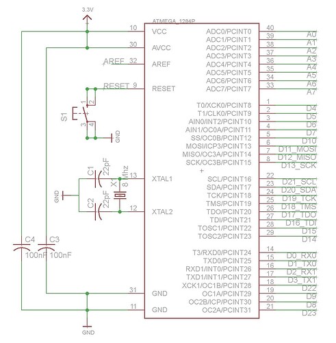

Hi, so good progress with this 1284p project, thanks for all your help
All up and running on 3V3 @ 8mhz and responding well. My next task is to get the pin map sorted but I'm not sure what I'm doing.... does anyone know of a good tutorial or can help me match the pins_arduino.h below with my schematic below? Thanks.
