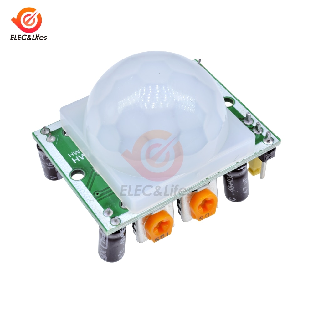

Most full function PIR sensors such as the HC-SR501 already provide a persistence delay control so you only need to connect it to a relay module

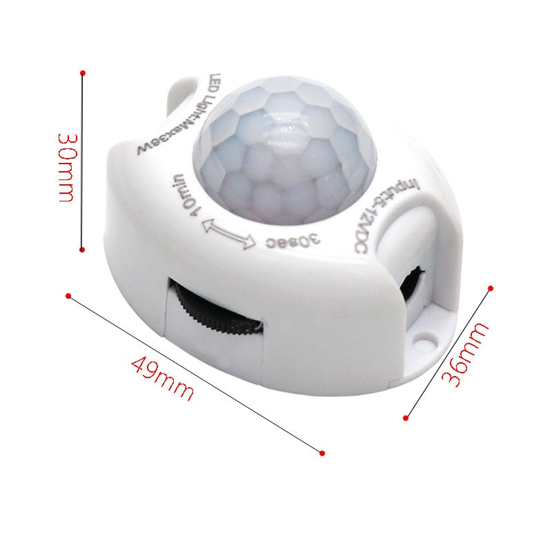

However you can get one already set up to control your light strip.
