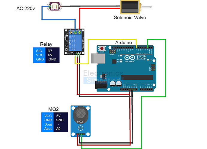

Im creating a project where im powering a 12v relay and 12v solenoid with a 12v dc adaptor, then connecting these two to an arduino which is then connected to a 5v gas sensor. This is the circuit diagram I'm using:
the only difference I'm doing from this diagram is I'm using a 12v dc power source. why is my relay not turning on. when I power the solenoid from the adaptor it turns on, and then I plug in the arduino into the USB, the relay, sensor, and ardiuno light up. so everything is powered but the sensor isn't shutting of the valve. But I assume this is because they arent being power from the same source.

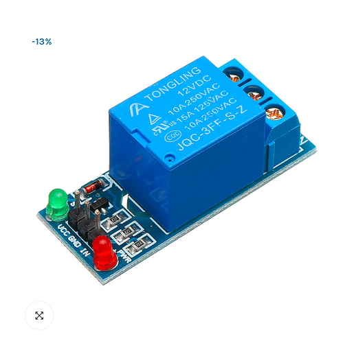

Can you show a picture of the relay module you have or a link to the place where you purchased it.
Its connected to both d7 and v5
this is the relay i have:
So it does not work because that relay needs 12V connected to Vcc but DON'T do that yet.
Is it a low level or high level trigger?
high level.
Then connect Vcc to +12V
Connect GND to -12V AND to the Arduino GND
Connect sig to D7

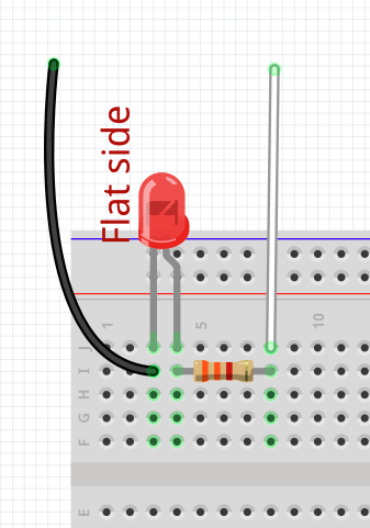

Do you have any LEDs?
yes. however i saw a video where i could check the wires through salt water, and the one that has a reaction is the postive whereas the other is negative.
That sound a little crazy.
If you have an LED and a 3.3K ohm resistor, you can check it with that.
i didnt have a 3.3k ohm resistor so i tried the water thing and suprisigly it worked. the black cable made a large reaction while the white did nothing. this means that my black cable is the positive and the white is negative. should i proceed with these instructions?
