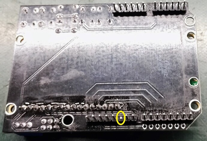

Yes everything is like you say. Except the fact that I can not find "Backlight control" . Could you show it on the picture?

It is not possible to show "Backlight control" on that picture.
Arduino pin 10 is used to control the backlight circuit that controls the backlight.
The backlight transistor circuit is under the LCD module on the shield.
As I mentioned in reponse #1 above, there is a thread I started where
you can read about a h/w issue that many lcd keypad shields have that depending on how you use arduino pin 10 could damage the arduino processor.
There is a description of the issue and an attached schematic that you can view to see the h/w design flaw in the very first post of that thread.

Not exactly. The shield you have has a bad backlight circuit design that can potentially damage the AVR chip.
If you set Arduino pin 10 to an output and set the pin to HIGH, it creates a short to ground which overloads the pin and can damage the AVR chip. There is also a problem using digital PWM ( analogWrite() ) since that also sets the pin to HIGH while doing the pulsing.
As long as you avoid setting D10 to HIGH then it can be ignored.
But, perhaps it is better to do preventive measures and add just one diode to the circuit board as you had shown in the sticky?
There are several alternatives on dealing with the issue from not using backlight control and not using D10 to s/w work arounds to a couple of h/w modifications.
If you never intend to control the backlight, you can even clip the D10 header pin on the shield.
Just to be sure: Should I clip pin marked with X?
That appears to be correct.
The pin to clip on the LCD shield is the pin that plugs into the header on the Arduino board for digital pin 10.
But once you do this, there is no going back. You will not be able to control the backlight.
The backlight is on by default but you will not be able to control it.
If you you are wanting to permanently disable d10 from backlight control,
if you look at the back of the shield there may be trace that goes to that header pin that you can cut instead of clipping the header pin.
That option would offer a way to re-enable the backlight control should you decide you want to use it in the future.
--- bill
Did not see possibility to do it differently, so pin is clipped off. Seems that I will not be doing backlight control with this LCD display. :slight_smile: Not a big deal.
