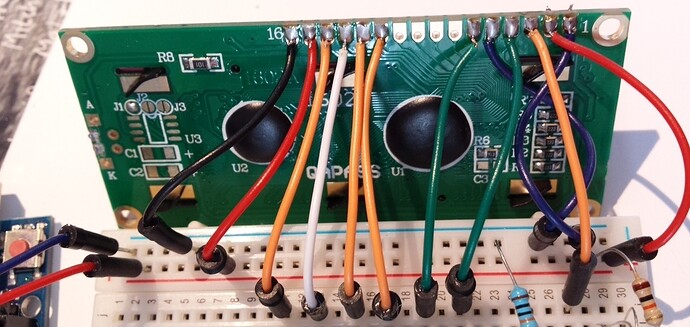

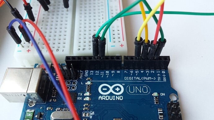

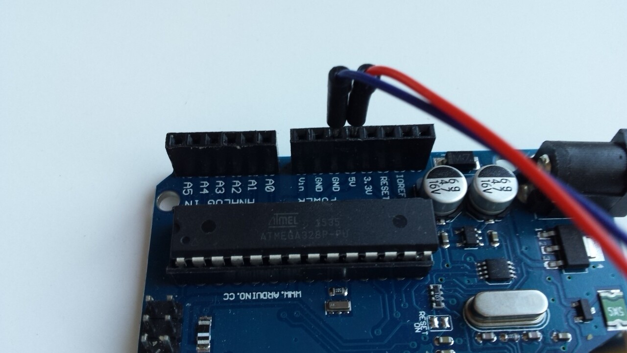

We have to be able to follow each wire from your display back to the Arduino and none of your photos are quite good enough for us to do that.
From what I can see it looks as if you may be using Arduino pins 13 and 12 instead of pins 12 and 11 for RS and RW.
Don
Unfortunately not. 11 and 12 is correct set.
I have checked the cables several times also the connection with the multimeter.
maybe the attached photography is better
Damn! Attachmenting is not woeking with my phone :frowning:
EDIT: did it now with the computer. Picture is helpful now?
Not really.
Are you able to follow the wires that disappear off the top of the picture?
Can you see the connections to the lower numbered Arduino pins?
Why do you have similarly colored wires adjacent to one another in two places? Wouldn't it make sense to swap one of the green wires with one of the yellow ones?
Are you sure that you checked the continuity of all of those jumper wires, they are well known to be troublesome?
Don
francwalter:
It is not helpful.
We can not clearly see where the wires are going.

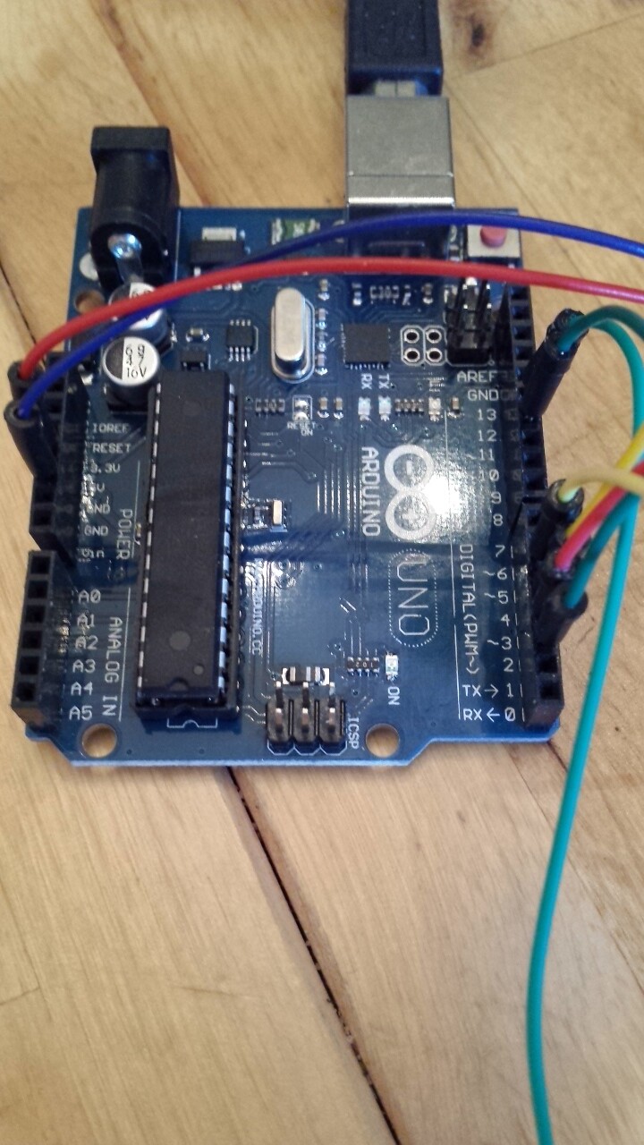

You have wires going into space out of the frame of the photo and then we can't see where they are going especially since so many of the wires are green.
And then the looking down view is very difficult to tell which pins are being used on the Arduino.
You need to post a photo that some one else could use to replicate your wiring.
In order to do that, they need to see where every wire is going.
Even with your 5 photos I still can't tell how you have things wired up.
It also looks like the wiring in IMG_20170621_20576-1 and IMG_20170621_205916-1 not the same as the wiring in IMG_20170622_140130-1 with respect to the RS and EN pins.

Back up a bit and show everything and then show the headers from the side so that we can see the wires going into them vertically so that there is no parallax issue.
This will allow us to verify that the wires are going the proper places.

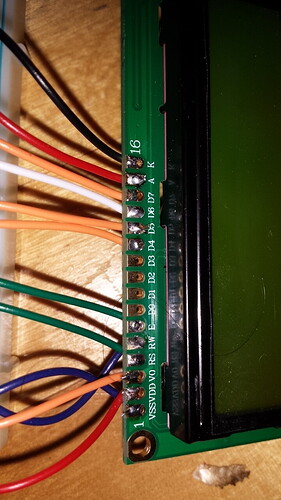

The soldering looks a bit suspect on a few LCD module pins.
(I can see a fully open hole on a few of the lcd signal pins)
Overall, the photos are simply not good enough for us to be able to tell if there are any wiring or soldering issues.
In a little over 8 years of seeing many people on the Arduino forum with LCD issues , I can count the bad LCDs involved on one hand - and I don't need all five fingers.
So the likelihood of a bad LCD module is quite low.
I've seen cases with poor solder connections, bad wires, bad bread board connections, not making connections between a pin and an arduino header on the Arduino board and bad pots.
I've also seen many cases where the person fully believes that the wiring is correct but it turns out that the wiring was in fact incorrect.
Also, from the little I can see in the photos, it appears that it was wired two different ways.
If we can't see clear photos of the wiring and the soldering we simply can not provide any feedback with respect wiring or soldering issues, and in my experience those are the two areas that are most likely to have issues.
--- bill
OK, thank s, I put some other foto now :slight_smile:
Assuming you are using this constructor: LiquidCrystal lcd(12, 11, 5, 4, 3, 2);
Then the wiring matches and looks ok.
However; some of the soldering doesn't look so good.
In particular the E signal. I'd go add some solder to all the connections that still have an open hole on the LCD.
In particular the E signal. I'd go add some solder to all the connections that still have an open hole on the LCD...
OK, soldered it again and filled the wholes, see images.

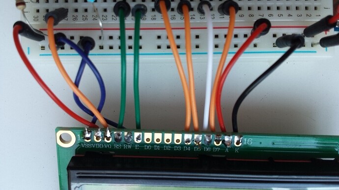

Excellent photos. I wish they were all that good.
Your soldering looks fine. Your Chinese jumper wires do not look as if they are intimately connected to the breadboard. Push them in snugly.
Your 11 pixels high means that it thinks it is in 1-line mode.
Double check the wiring. Reload the example sketch. You should be fine.

I'm still waiting for the photo that allows me to unambiguously follow each of the six wires that connect the LCD to the Arduino.
The extra three rows of pixels could possibly be from an initialization for a single line display with a 5x10 font although that doesn't explain the 11th row of pixels. Such an initialization could possibly result from miswiring.
I suggest that he remove all of the wires between his breadboard and Arduino and start again with the outline that I recently (re)posted here --> 16x2 backlight works but characters don't display - #10 by floresta - Displays - Arduino Forum
When he replaces the wires between the breadboard and the Arduino in step 4 he should make sure that adjacent wires do not have similar colors.
