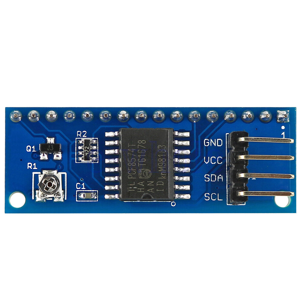

This is my LCD: LCD+I2C
PCF8574T is written on the I2C module chip.
I've tried two different pin configurations of the I2C module in the sketch however nothing still appears on the monitor (yes, I've tried to adjust the contrast but it's not the cause).

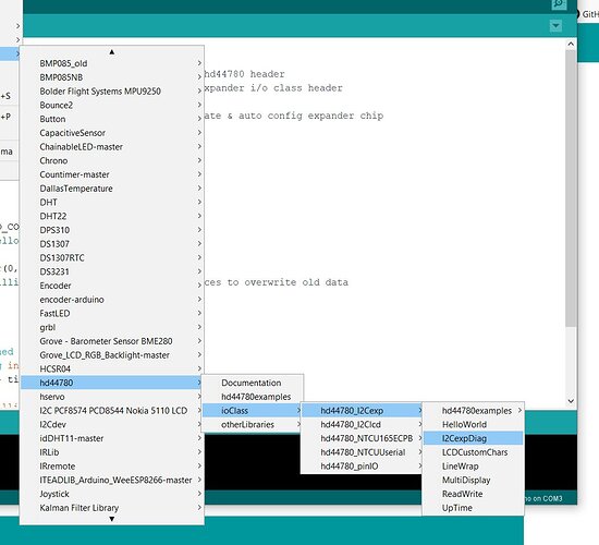

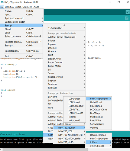

For an I2C LCD display to work, the I2C address and the I2C backpack to LCD pin mapping must be correct. If the library default settings for either or both are not correct the LCD will not work. You can try to figure out the right pin mapping and use an I2C scanner to find the address, but if you install and use the hd44780 library that is done automatically by the library.

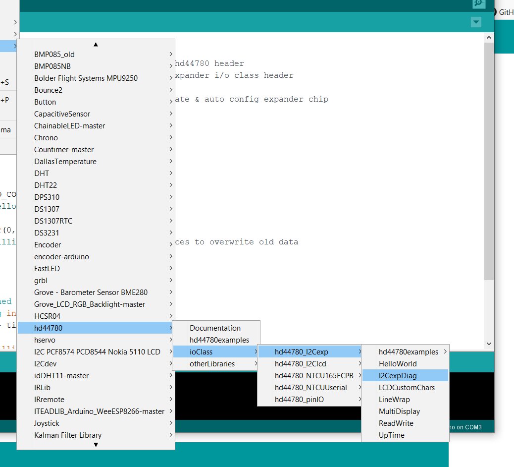

Install the hd44780 library. The hd44780 library is the best available for I2C LCDs. The library is available in the Library Manager. Go to Library Manager (in the IDE menus, Sketch, Include Libraries, Manage Libraries) and in the Topics dropdown choose Display and in the Filter your search box enter hd44780. Select and install the hd44780 library by Bill Perry.
The class that you want to use is the hd44780_I2Cexp class. There are examples to show how to use the library. The nice thing about the hd44780 library is that it will autodetect the I2C address and the I2C backpack to LCD pin mapping.
In the examples, there is a diagnostic sketch that will help us to help you if you still have trouble with the display. Run the diagnostic sketch and post the results.

Here is the path to the I2Cexp diagnostic example (I2Cexpdiag.ino).

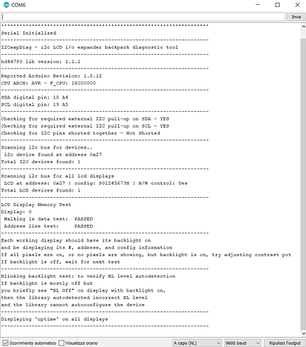

I attach the result of the test.

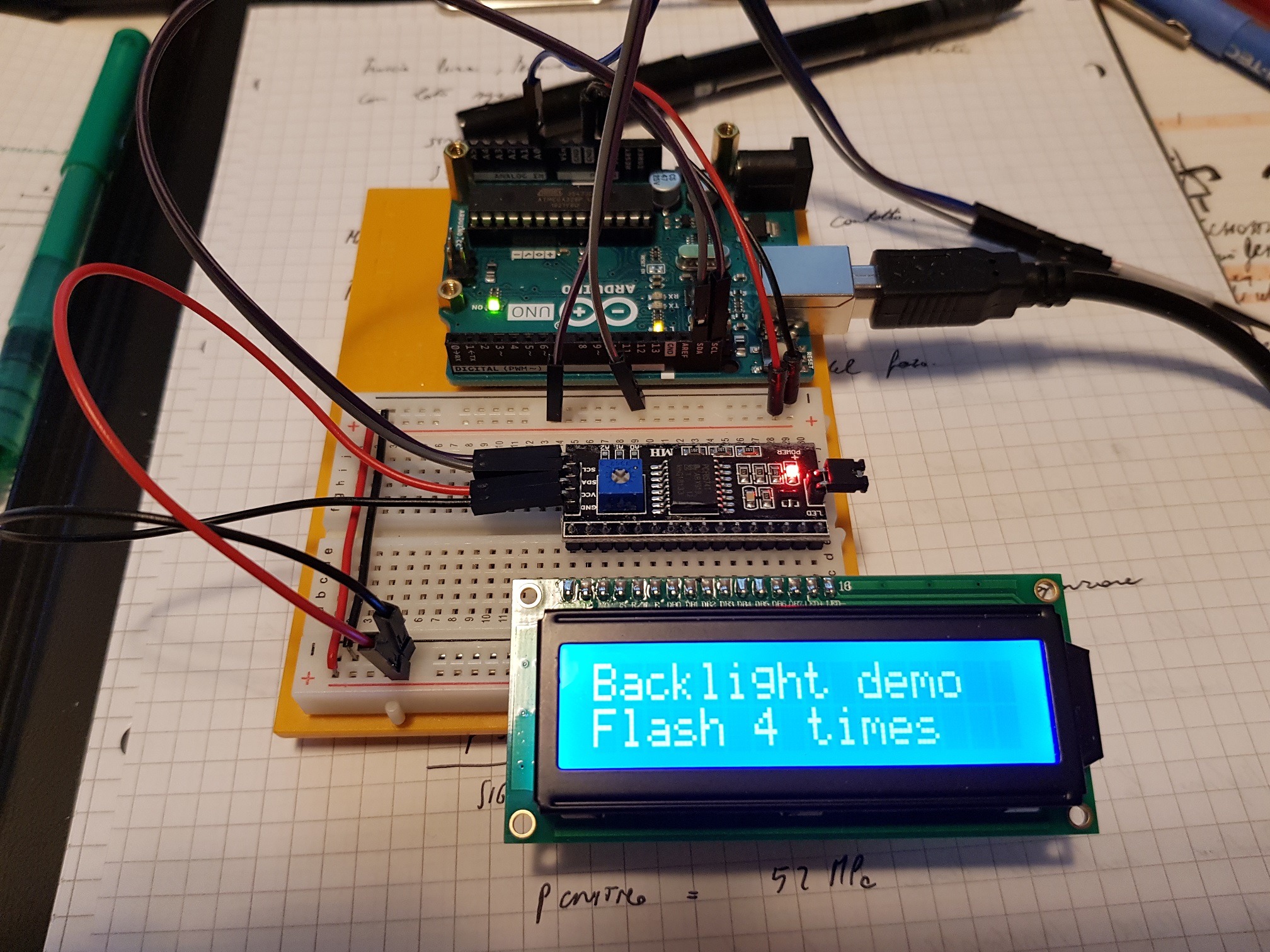

I've soldered all the pins again. It looks like they weren't soldered well enough.
Now it works!

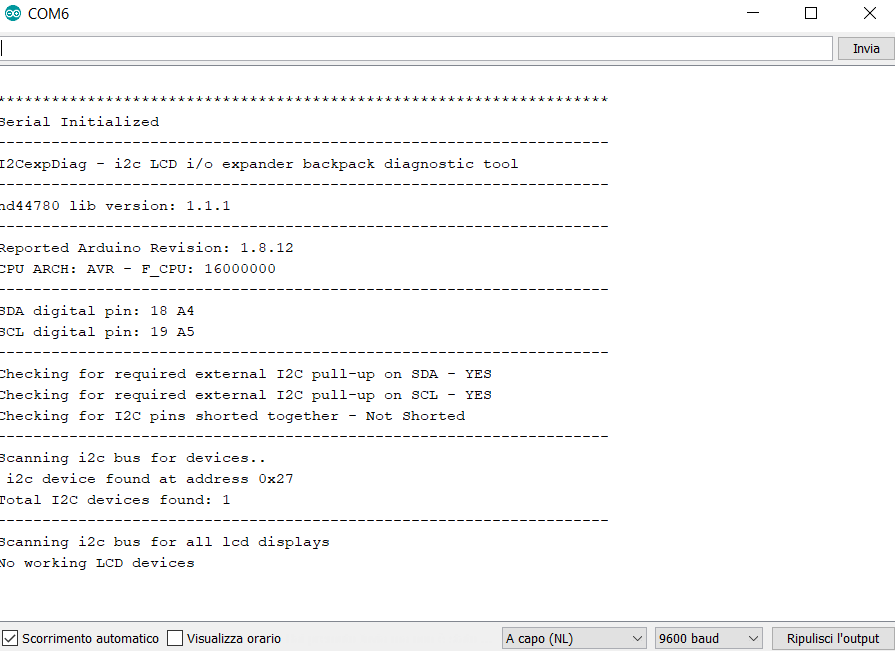

One last question: I've tried again even the test and I've got as a result what you can see in the attached pic. Why does it say "no working LCD devices"?
I can run sketches and it says no working LCD?
I have seen that busy stuck message before. It think that it turned out tht there was a solder joint that was bridged by a tiny bit of wire or something. Though if the display works, I am not sure that there is anything wrong.
Are you saying that HelloWorld works but the Diagnostic fails?
That is odd since if the diagnostic fails, the LCD normally won't work for other sketches.
If the diagnostic is reporting that BUSY is stuck, then there is a problem communicating with the LCD and that is why it reports No working LCD devices.
This needs to be resolved as it will likely cause other issues, since there is likely some issue either reading from the PCF8574, or the connections between the LCD and the PCF8574.
This is second case I've seen this happen recently. The other case, a few days ago, was due to a soldering issue.

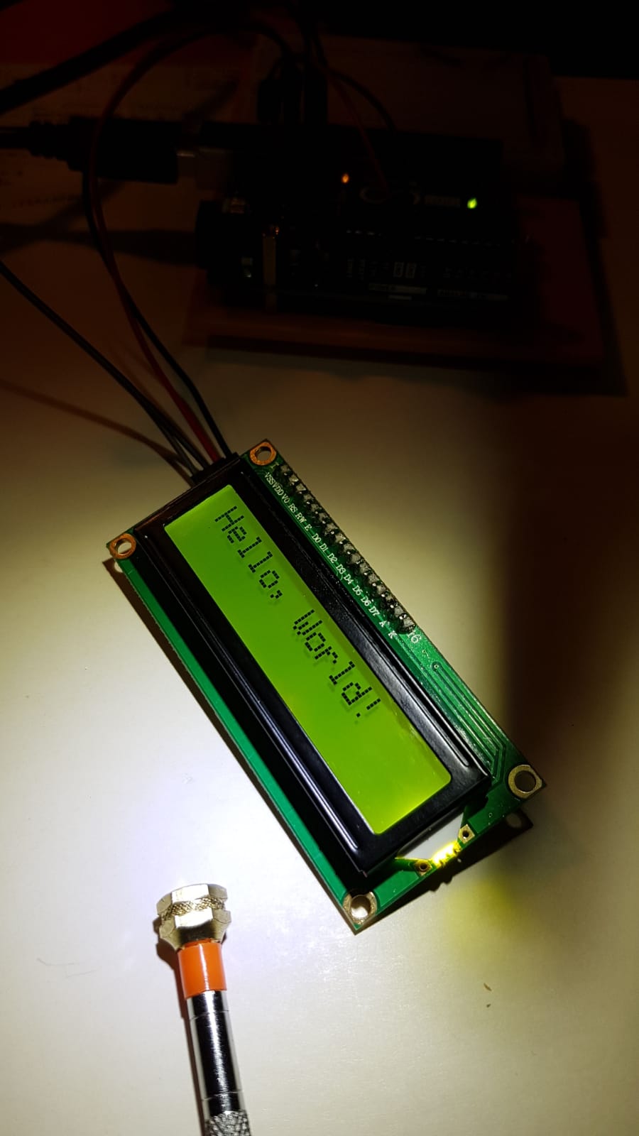

I have to say that after some time working properly the LCD started to display strange characters. Before that the right characters were blinking while the LED backlight was always ON. Ithink I have to order new I2C modules since I have another 16x02 LCD working good with the traditional 4 data wires connection. This is the module I'm gonna buy: I2C module

I have to say that after the second soldering there was some short circuits between the A and K pins. that led to LED backlight flickering. I removed the cause of the short and now the backlight is on persistently but the characters displayed are strange.

I don't see anything wrong in the images, but they are kind of small and the drop box site makes viewing them kind of hard on my tablet.

It sounds like you may have made some changes since you sent us the diagnostic output.
(multiple soldering)
We need to see everything as a snapshot.
photos of everything, and the diagnostic output at the time the photos are taken.
Then make no other changes until we discuss.
What is the diagnostic tool reporting now?
It looks like there may be an issue on PCF8574 pins 9 and 10.
If you look at 20200410_211738.jpg it looks like there may be a small small hair/wire laying across PCF8574 pins 9 & 10.
These pins are on the opposite corner of the chip from the little marker hole on pin 1.
In the photo, it is the upper right corner of the chip.
It looks like a small fine piece of wire. If so, that could create issues.
--- bill
One other soldering issue.
It is hard to tell but from looking at 20200410_211738.jpg as the angle and the shadows make it difficult to see but
it looks like there might be a soldering issue on pin 8 of the backpack.
In the photo count up from the bottom 8 pins. pin 8 is located about in the middle of the PCF8574 chip.
--- bill

  1. I've tried the diagnostic sketch and I've read something regarding bad soldering in it... I closed the serial communication and I've started to write this post, then I reuploaded the diagnotic sketch and opened the serial communication again. This time it looks like everthing is ok.
4)After closing the serial communication I reopened it and I read what is present in the attached .txt file.
5)Pissed off I closed and reopened the serial communication and everything was ok
So, long story short, one time the test is passed, the next one LCD memory display test fails.
The pins are not shorted anymore though.
  1. I've tried to load the first sketch again and this is what appears... It looks like the LCD is tired too...
I think I will buy another I2C module :slight_smile:

The issues you are seeing are consistent with soldering issues.
Given it comes and goes, I would suspect one or more cold solder joints that are sometimes making connections and sometimes not.
These devices are pretty simple and rarely fail but
debugging stuff like this requires careful attention to details and being very methodical.
I'm not sure what all you are doing as you seem to be bouncing around trying several different things and using multiple LCD libraries.
Again, there is no point in trying other things until the hd44780 library I2Cexp diagnostic tool says the h/w and the hd44780 library hd44780_I2Cexp i/o class is working.
I would recommend sticking to using the hd44780 library.
There were two potential soldering issues that I pointed out. Have you looked at them?

  • The hd44780_I2Cexp i/o class is much faster than any of the LiquidCrystal_I2C libraries.
  • It is better maintained
  • It has API functions for the LCD API 1.0 and LiquidCrystal API compatibility.
  • It has additional features not available in other libraries like automatic line wrapping of long lines, and ability to read from LCD RAM
  • hd44780_I2Cexp i/o class includes a diagnostic tool to verify the that the library and h/w are working correctly.
  • Lots of included documentation including all API functions that can be brought up from the IDE.
  • Included documentation includes links to other LCD & chip related information and 3rd party tools
  • Better and more extensive examples

Clearly the previous module was faulty.
Given that it was coded to write the single string "Hello World!", there really is no plausible way a solder bridge, bad connection, faulty backpack - or simple code error - could cause it to miss a four-character group.
Poor contact with the "Zebra strip" due to assembly error or dropping the display on the ground is a possibility - it would be interesting to see this display tried again with a known working code that displays all characters on both lines since it is presently easy to swap given Lucky-Luka's recently-developed aversion to permanent soldering. :grinning:
