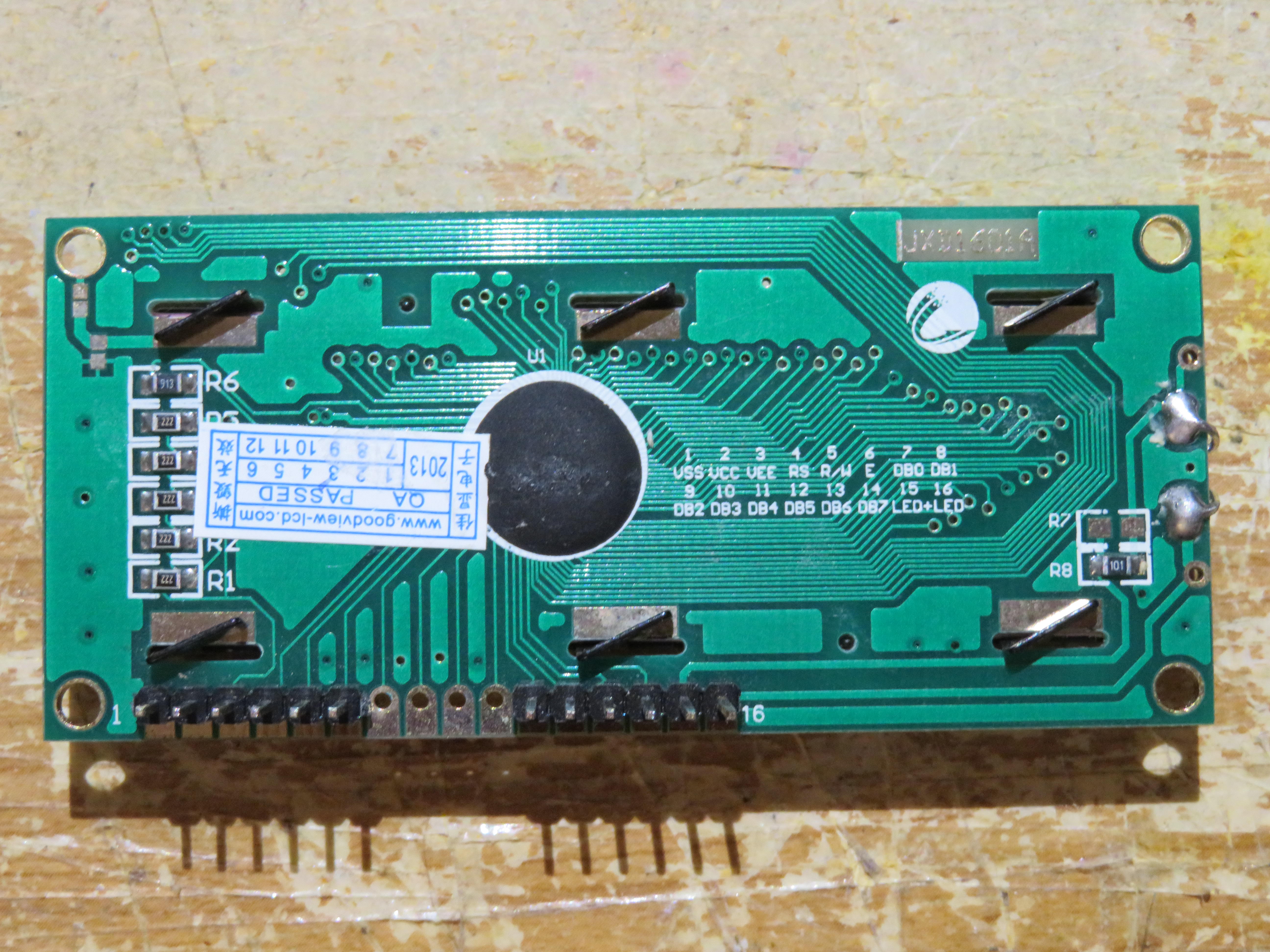

16x1 LCD not working as expected?
Got a new 16x1 LCD in today but it's not working as I expected. When I print a string to it that is longer than 8 but not longer than 16 characters, only 8 characters are printed. I did some testing to verify wiring is correct and used a 16x2 LCD I had around. Video of it in action
If I printed a string of 9 to 16 characters to 16x2, all are on one line but if I printed one string to 16x1 display, only the first 8 are printed. The test I did shows the other 8 are working but it's on second line! It's like I got 8x2 display with 16x1 LCD panel.
Did I get a lemon? There's only 2 sets of solder pads on the back. Backside of the panel:
quick edit: if it's not a lemon but a quirk of Nx1 displays, how would I split a string so the first 8 are on first line and second 8 characters are on second line so it'd appear to be unbroken 16 character line?
That's pretty much what you have!
It's a quirk of most 16x1 displays.
You have to tell the library that it is an 8x2 display and then you re-position the cursor to the start of the 'second' line in order to put characters on the right half of the display screen. You pretty much figured this out already.
For all the gory details follow the LCD Addressing link at Don's Collected Technical Information .
Don
Ok so I'd need to figure a way to split the variable across 2 "lines". Here's my entire code:

lcd.print on 0,0 works for the first 8 characters, how would I put the second 8 characters from inside gameSys[presses] so it'd appear on 0,1? I tried -7,1 but that doesn't seem to work, 0,32 does work but it just seems a little messy if there's a way to take only the right 8 characters and stick them in 0,1
Untested. I understand that the new HD44780 library can do automagic line wrap.
So if you try it on your 8x2 it should wrap onto the second line i.e. the second half of the 16x1
On the other hand, it might be too clever and start a new line to avoid splitting a word.
Most regular LCD libraries do not wrap.
David.
You might just try to find a 'real' 16x1 display. It will have two ICs (or epoxy blobs) instead of one.
Also, with that type of display you may be able to invoke a larger (5 x 10) font although I'm not sure if any of the libraries support that feature.
Don
Yeah, that type of display is pretty difficult to use with "standard" arduino LiquidCrystal type libraries.
I would go so far to say it actually sucks.
However, the hd44780 library can do automatic line wrapping to make it work the way you want it work.
There is no sort of word wrapping in hd44780; it is very simple.
When enabled, it wraps to the next line when characters get to the end of the current line
and back to the first line if on the bottom line.
There is no scrolling capability.
The hd44780 library should be smart enough to handle that type of display.
What you will want to do is initialize the display as an 8x2 display.
Then tell the library to do automatic line wrapping by calling lcd.lineWrap()
After that, you can treat the display as if was a 16x1, including using setCursor(col, row)
when col > 7
i.e. you can set the cursor col to any position between 0 and 15 on row 0
and it will work as you want it to work. Even though the display is really 8x2, it will work as a 16x1
The hd44780 library can be installed directly from the GUI library manager.
There is even a LineWrap demo sketch example to demonstrate this.
Read the comments in it, but basically you just need to set the geometry to 8x2.
If you are currently using the LiquidCrystal library you will want to use the hd44780_pinIO class in the hd44780 library. See the examples for what header files you need to include and the constructor parameters.
Start by looking at the HelloWorld sketch.
See the hd44780 github page for more information: GitHub - duinoWitchery/hd44780: Extensible hd44780 LCD library
And also read the wiki: Home · duinoWitchery/hd44780 Wiki · GitHub
as it explains where the examples are for each i/o class.
Use the IDE GUI library manager to do the install, do not install it from a zip file.
--- bill
Bill, that is a big help! Automatic line wrapping works great on cheap 16x1 displays. It seems to work fine with hd44780-compatible VFD like Noritake CU series.
So I assume you got it working on your 16x1 display?
I threw in some special support to make sure the library could handle those types of displays after seeing people struggling with them.
IMO, having to handle the line breaks in the application is simply not workable.
The 1.0.0 release is getting closer. Likely in a few weeks.
If you see any issues please create github issues so they can get fixed.
--- bill
