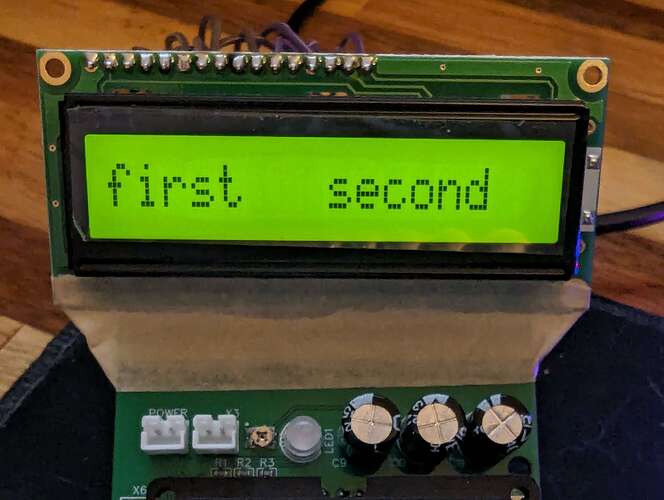

I have done a lot of research to try to get my 16x1 LCD working but I haven't been able to. I am able to print characters on only the first half of the display.
I am aware of the very helpful work that has been done by Donald "Floresta" Weiman in this area. I believe I have read all of the relevant content on their website but sadly I have still not solved this problem.
After looking at countless threads, I'm also aware of the usual answers these posts get which have unfortunately not helped me. I've listed below the proposed solutions that I have already tried:
  • "16x1 displays are actually 8x2 internally so you need to configure the LiquidCrystal library as such and move the cursor to the second line to display text on the second half of the display."
  • "Check your wiring."
  • "Try printing a bunch of characters across the entire RAM range to see if characters show up on the second half."
  • "Try the hd44780 library and use their LineWrap example sketch." (result was the same, only displaying on the first half)
None of these proposed solutions have worked for me despite them seeming to work for literally everyone else. I'm thinking my LCD might be an oddball and I should just buy a different one, but I wanted to make a post as a last ditch effort to see if I can still use this one as it fits my project perfectly and I've already bought two of them.

I found the solution, finally. Somehow I dug up a thread that I hadn't seen during my extensive searching.
The creator of the hd44780 library replies and mentions that the ideal potentiometer value for the backlight contrast may be different when the display is configured to have 1 line as opposed to when it is configured to have 2 lines because the duty cycle of each active pixel is higher when configured as a 1 line display, which makes complete sense.
Sure enough, I uploaded the below code configuring the display as 8x2, gave the pot a fraction of a turn, and the display lit up showing text on both lines.
Code
#include "Adafruit_LiquidCrystal.h"
Adafruit_LiquidCrystal LCD(4, 3, 5, 6, 7, 8, 9, 10, 14, 15);
  LCD.begin(8, 2);
  LCD.print("first");
  LCD.setCursor(0, 1);
  LCD.print("second");
Result
This is a cautionary tale that tells of the dangers of assuming that your contrast is not the problem, even if your LCD works in certain circumstances.
Major hallelujah moment. I'm off to go run into the next brick wall!
The contrast pot adjust has no influence on this 8x2 vs 16x1 printing issue.
Contrast adjustment has no effect on where characters are stored in DDRAM or how they are displayed on the physical display.
The contrast pot controls, well, the contrast of the pixels on the display.
So while the ideal/necessary pot setting can be different for a 1 line vs a two line LCD,
the pot setting does not control anything related to printing characters on the left vs right side of the LCD.
A Vo voltage (contrast pot setting) that is severely out of proper adjustment will either cause all the pixels to be off or all the pixels to be on.
i.e. it affects ALL the pixels on the display.
In terms of write() vs print() using either will produce the same results.
This is because the print() function in the Print class calls the write() function for each character.
When using the hd44780 library,
this does not seem possible if things are configured properly.
When using a 16x1 display that is really an 8x2 display (like the one you have)
If you use the hd44780 library, configure LCD for 8x2, and use LineWrap()
then the sketch should be able to treat the display as if it were a 16x1 display
i.e. clear the display or set the cursor to 0,0 and print 16 characters.
Your second code is different from your first code.
The first code was attempting to write 16 characters at DDRAM address 0.
This will not work since the right side of the display starts at DDRAM address 0x40
The second code writes 8 characters at DDRAM address 0
and then 8 characters at DDRAM address 0x40 by setting cursor position.
i.e. original sketch treats the LCD as 16x1 and second sketch treats the LCD as 8x2
That is a big difference.
The hd44780 library allows you to configure the library and LCD to be a 8x2 display but then allow the sketch to treat it as if it were a 16x1 LCD.
Did you try the included LineWrap example.
Note:
For your "16x1" display (which is really a 8x2 display) you will need to edit and modify the LineWrap example sketch.
You will need to change the LCD_COLS to 8 to ensure that the library & display is configured as an 8x2 display.
But after that, the sketch can talk to the LCD as if it were a 16x1 display.
One thing you won't be able to do is use the shifting functions.
Those will not work properly when using this mode.
--- bill

I appreciate you sharing your knowledge and adding additional context to this thread, but I'm a little confused about some aspects of your reply and I think anyone finding this thread later may also be confused by some of what you typed.
Regarding you refuting that the contrast adjustment had any effect on the addressing of the display, I don't believe I ever implied that and I certainly don't think that. Discussing that idea seems like it just adds unnecessary confusion to this post. Perhaps I'm just not seeing where this may be a point of confusion for readers, though. The big takeaway from the post should be that the ideal potentiometer value for the backlight contrast may be different when the display is configured to have 1 line as opposed to when it is configured to have 2 lines.
I would like to attempt to clarify what you typed here. I believe when you say, "this 8x2 vs 16x1 printing issue" you mean the greater issue of 16x1 LCDs being internally structured as 8x2 and you don't mean the specific scenario my post is about. Because in my scenario, the potentiometer value was critical to the problem I was having and definitely did affect how the characters were displayed on the physical display. But you are trying to highlight that the contrast setting isn't relevant to the unique addressing of 16x1 LCDs, which is the understanding I believe most people would have.
As for the rest of your reply, it is all very valuable knowledge for anyone finding this thread later. Your library seems a little easier to use when trying to use a 16x1 display than the LiquidCrystal library. I wish I would have used your library because it may have reduced a little bit of the complexity of my program, but unfortunately my code is already written.
I think we both suffered from using some ambiguous language that may have created some confusion.
It appeared to me that you did.
Which is why I did the followup up clarification.
What reinforced my belief that you were implying contrast affects addressing is in what was said and shown in the first post.
This is what lead me to this conclusion.
In your OP (post #1 of this thread)
you showed a photo of a LCD that DOES NOT have a contrast issue and seems to be working normally.
You also stated that you tried running the hd44780 library using the linewrap capability and it produced the same 1/2 display output.
That simply is not possible - so now, I'm trying to guess what was actually done.
Then a bit lower in the original post there is mention of blank display when two rows are used.
So I was not sure what you were doing/seeing or what issue you were chasing.
i.e. were you trying to understand the DDRAM addressing or trying to understand a contrast duty cycle issue, or perhaps thinking that changing contrast was moving the characters off the display to some other DDRAM address.
Combine that with this comment:
So that is why I added the clarification as there seem to be confusion over what was happening and why.
