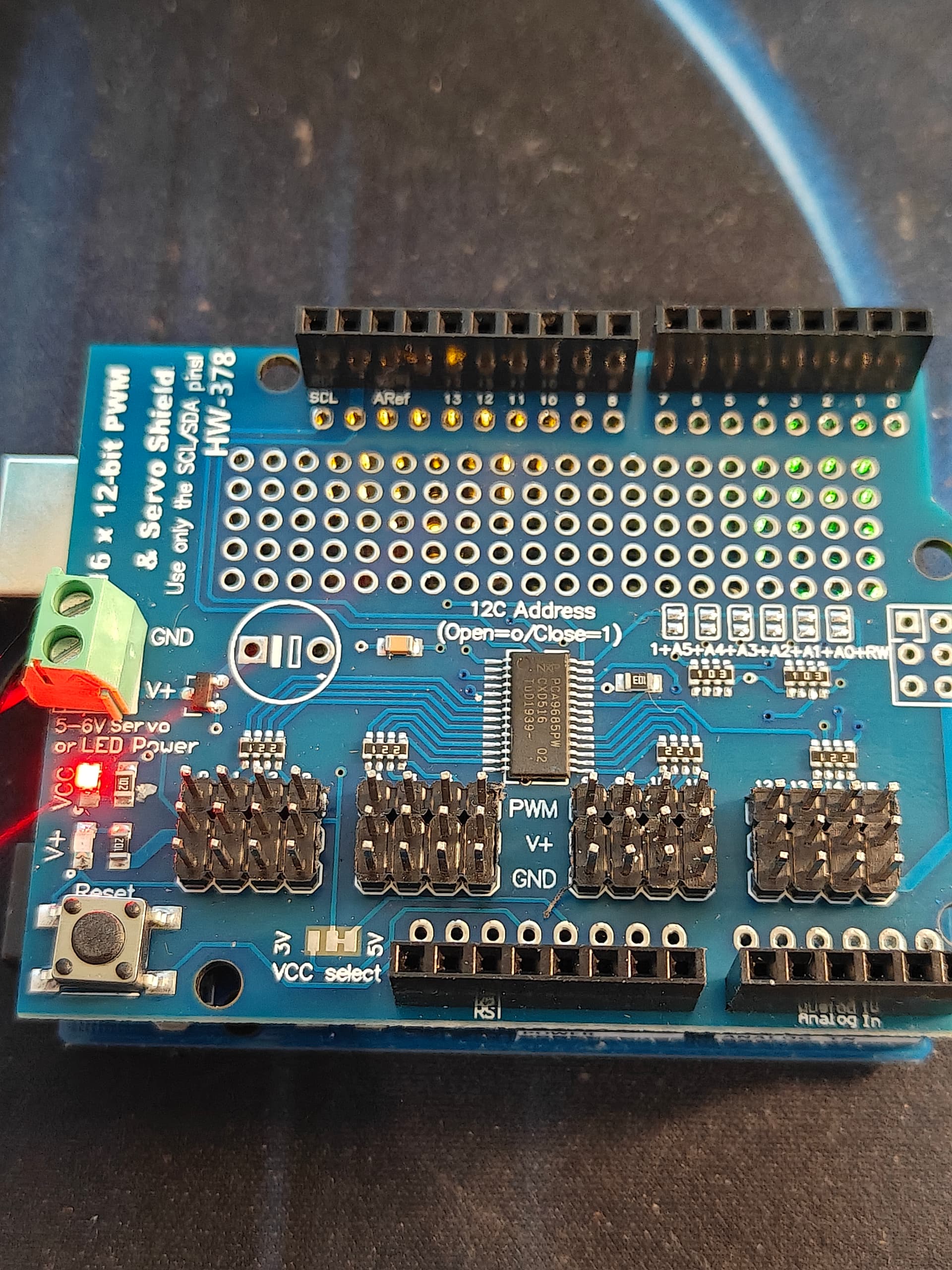

For a project I'd like to drive 7xSG90 servo's using arduino uno. I bought a shield off a chinese supplier (First I looked at an electronics supplier online, they had a 3rd party board, I searched through chinese suppliers and found the exact same one, via's in the same place and all, but for 1/5th of the price. I generally have good experiences with chinese suppliers so I took the risk) but I can't seem to be able to drive a single servo using it (Servo's are also chinese supplier).

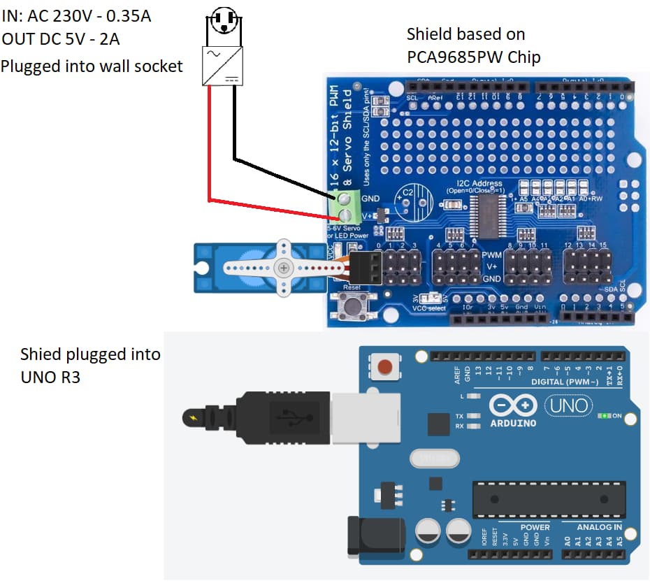

Setup:
  • 16x12bit PWM servo shield (HW-378, it seems to be using the PCA9685PW chip)
  • SG90 attached to 0 (Yellow to PWM, Red to V+, Brown to GND)
  • Elegoo uno R3 powered through USB
  • Samsung Travel adapter 5V 2A as power supply to Servo shield V+/GND
  • PWM_servo_test example sketch from adafruit PWM Servo Driver Library.

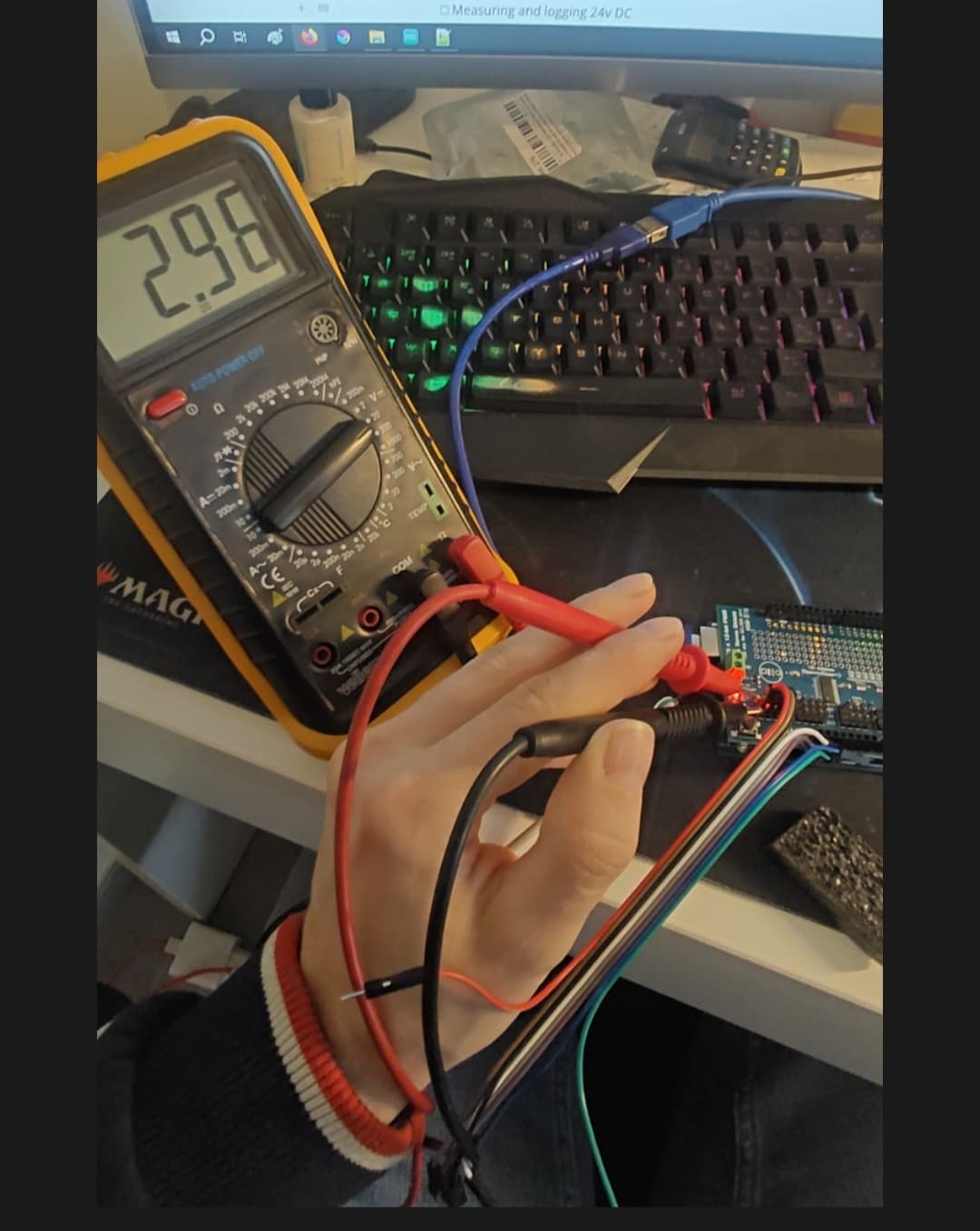

  2. Measuring the V+ & GND: it gives 5.10V on all the pins (both input and the pins you plug the servo in.
  3. Adjusting the Wire.setCLK. from 400kHz to 4kHz, it changed nothing.
  4. Measuring the PWM towards GND using multimeter on DC, which gives and indication if there is a signal or not, but not more or less then that: it gives alternativly 0 and a rising value (highest value measured was 2.96V DC).

Post an annotated schematic, that will help us help you.
Hello,
If you're looking for the actual schematic of the PCB, I don't have that since the supplier did not provide it. I can however, post a better picture of the shield itself if you're looking for the resistor values.
this is a principal drawing of what I'm using right now:

Since I cannot edit a post with an URL in it (getting an error) I'll reply to my own post. I found this schematic of the shield, which seems to be the same as the one I have (so it is a clone from the adafruit design). I measured the '#0E' pin and it seem to be corresponding to the schematic.
Also the resistor values on the PWM pins are 220: it does seem that the clone did not cut corners on resistor values and stuck to the original design.
