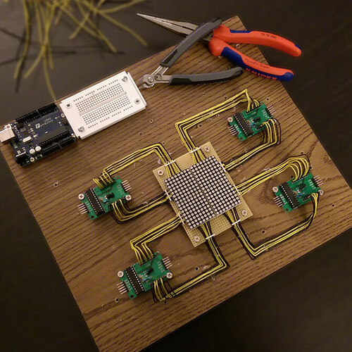

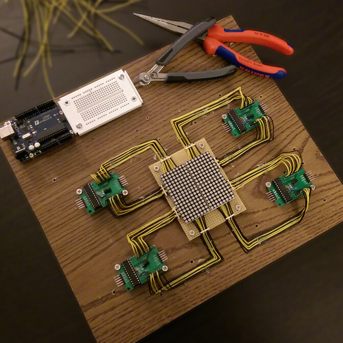

About the matrix: I didn't have much time to go deeper into this but this weekend I decided to sacrifice some time and some parts. I quickly slapped together some kind of prototype (yeah, it's not really pretty) which I can use to test some code later.
FYI: I had to solder the matrices. I bought some cheap-a** sets from amazon only to realize that the matrices wouldn't fit on the sockets of the boards. Didn't matter though, since I bought those sets just for the MAX7219 chip. One set (chip, board, matrix) did cost me excatly the same as a single chip at that time so I didn't care. :wink:
Looks rather neat to me, so far. :grinning:
Vulpecula:
I bought some cheap-a** sets from Amazon only to realise that the matrices wouldn't fit on the sockets of the boards.
I find that surprising. In what way would they not fit?
Paul__B:
The socket-rows (not the spacing between the sockets) are just a little too close together. But still too much to fit the matrix by bending some pins. Now that I think of it, I could have tilted the socket rows (with the help of a soldering iron) and MAYBE they might have fit. Who cares, it's just cheap crap from China. :smiley:
Interesting!
You may have struck it lucky!
The LED arrays come in 3mm and 5 mm versions. The boards are designed for the 3 mm version, but the rows are wider on the 5 mm arrays and it looks like that is what you have been supplied. It looks suspiciously like you have been "Super-sized"!
