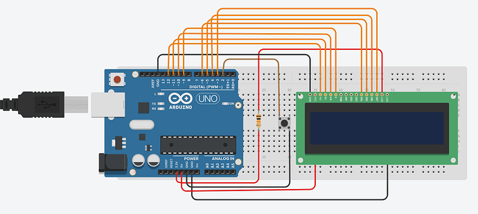

16x2 LCD display showing weird symbol [lcd.begin() called to late]
Hello, I am a beginner with Arduino. I have a problem where my LCD is showing weird symbols. Here are my circuit diagram, components, and the code. Can anyone help me?

  • Fully solder the display connections.
  • Use 5v and 220R with the display LED.
You must call begin() before you attempt to use any of the other API functions.
i.e.
lcd.begin() must be called before your initalizeGraphics() function.
--- bill
The code works. Verify your wiring and soldering.
