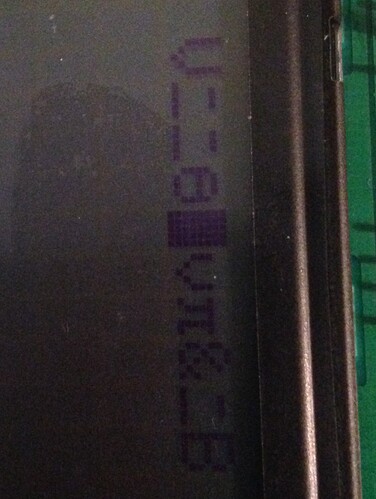

Ok so for the 16x2 i def fried it. I must if messed it up trying to figure out backlight.
For the 16x4 see the pic attached. Looks like the lines are correct it just printing nonsense.
Here is pic
I can't figure out how it could work properly for the code in reply #10 and then give the results shown in your image with the code in reply #12.
We need to see a clear picture of the entire setup where we can unambiguously follow each wire from one end to the other and also see the output on the display. We also need a copy and paste version of the code that resulted in the display in the photo.

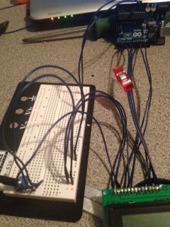

Well here is the pic of setup the best i could do. Sorry for using all blue jumpers.
I have D0-D3 soldered but are not in use.
Pin 3 is going to wiper on pot.
Pin 5 R/W is going to ground.
All others should be assigned correctly as code states.
Once i get internet to laptop ill post entire code.
Thank yall so much for any help!
Seasea19:
Well here is the pic of setup the best I could do.
You're kidding!
Take it outside in daylight, find a digital camera, hold it at least a meter away vertically and use the zoom.
