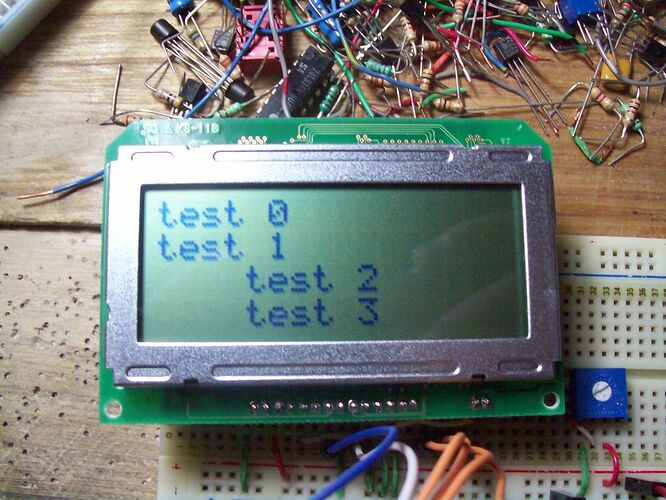

Hi guys;

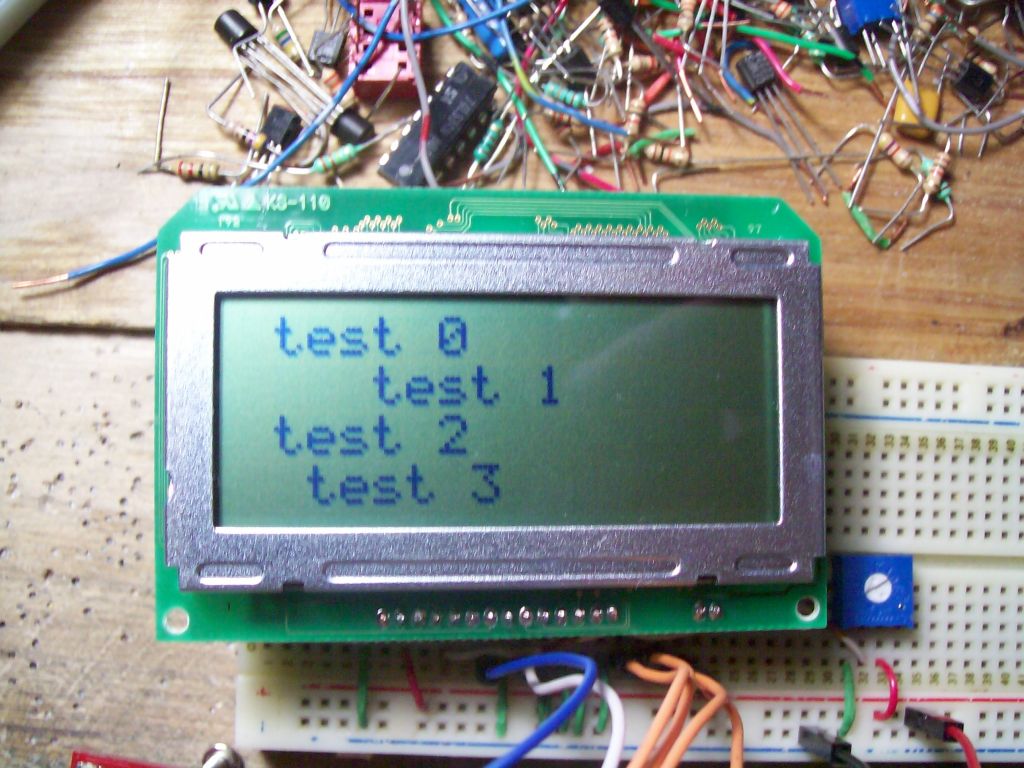

I just purchase this LCD ( see pictures ) and I code at first using lcd.begin(16, 4); and I use the lcd.setCursor(0,3); and lcd.setCursor(0,4); but it did not display at the 0 location, only the 2 top row, the bottom row start at location 4. I read the tutorial and it say: when you write a long string of letters/numbers, it is going to write into the 3rd row or 4th row. So I re-write my code and write for lcd.begin(32, 2); instead and test for position higher than 16. Guess what... it work...
I wonder why ?
Here the code : Bad one

The code that work :
// include the library code:
#include <LiquidCrystal.h>
// initialize the library with the numbers of the interface pins
LiquidCrystal lcd(12, 11, 10, 9, 8, 7);
  // set up the LCD's number of columns and rows:
  lcd.begin(32, 2);
  lcd.clear();
  // Print a message to the LCD.
  lcd.setCursor(1,0);
  lcd.print("test 0");
  lcd.setCursor(4,1);
  lcd.print("test 1");
  lcd.setCursor(17,0);
  lcd.print("test 2");
  lcd.setCursor(18,1);
  lcd.print("test 3");
Top picture : Don't work right
Bottom picture : Working right
Read towards the bottom about 16X4 displays:
http://web.alfredstate.edu/weimandn/lcd/lcd_addressing/lcd_addressing_index.html
IIRC, you need to modify the lcd library's row starting DDRAM address values to make them work on this display. If you don't want to do this (mess up regular 20X4 displays), try lcd.setCursor(16,0) for lcd.setCursor(0,2) and lcd.setCursor(16,1) for lcd.setCursor(0,3)
Mucking about with the lcd.begin parameters will not help until the LiquidCrystal library is updated. All of the versions up 'till now do not do much with the two parameters.
The first parameter is ignored completely - it just isn't used at all. It is probably there so that if and when they decide that fixing the cursor positioning problems with 16x4 displays is important they will have the information they need.
The second parameter is only checked to see if the number is '1' or something greater than '1'. This is really all the information that is needed in order to initialize the LCD controller properly. If they ever decide to implement line wrapping etc. then they will need more information from this parameter.
Nice to know...I am not ready to mess the lcd library yet... but your tip will definaly work well. And thank for the informative link.
