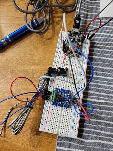

The MAX finally came in and I was able to get everything wired up, but I have either wired wrong or not updating the code from the example libraries properly.
Below are some pictures of my wiring. Hopefully the angles are ok, and the output. and below that is the code.

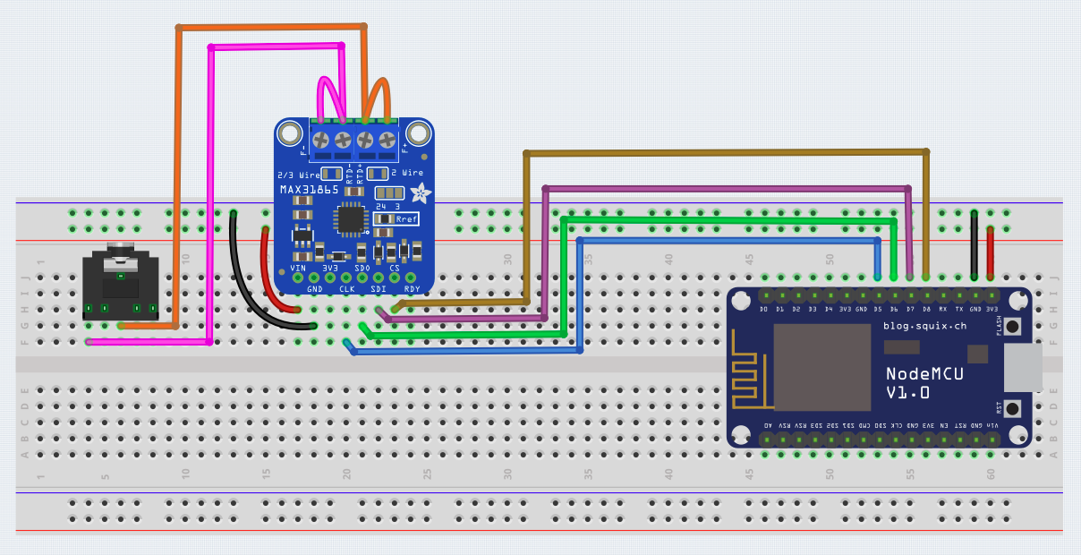

Thank you very much for laying all this out. I see the change you made on initializing the sensor instance to 15, but the sketch looks like what i did other than what digital ports used.
If you dont mind, can you please explain a little what i did wrong. I want to make sure i learn from my mistakes.
Thank you again.
It's a little difficult to follow your wiring with the photos you provided. All I can say is that whatever connections you made or did not make that were not the same as my diagram were wrong.
For the nodeMCU the default CS pin is GPIO15, so that's why 15.
The other pins are also the default hardware SPI pins for the nodeMCU

Awesome. No problem. I had a feeling it would be hard to follow everything from the pictures.

Finally getting back from vacation and was trying this setup last night. I ended up soldering the two spots listed above because the wires kept falling out.
For some reason, when i load the code you provided, the Node MCU keeps getting into a reboot loop where I keep seeing the console output from inside the setup method. Before i go down the rabbit hole of pulling things apart i was wondering if it is likely an issue with the firmware or maybe libraries not being loaded properly?
Thanks
Ok... so I figure out 2 things that are interesting...
D8 is going to MAX and the Node MCU documentation says this is where the flash is and used on reboot and must be pulled to ground. When I disconnect that jumper, I can push the code otherwise I get the espytool.py packet error. Also, a reboot works
Because of this, the right code you provided was not loading properly.
Is the best way to handle this is to pull it to ground with a resistor? Obviously every time it reboots, I don't want it to choke if D8 is connected.
My bad. Can't use D8 with the Adafruit board.
Switch the connection from D8 to D2.

Adafruit_MAX31865 thermo = Adafruit_MAX31865(4);
Ahh ok thank you. I saw that in the pinout reference you provided it would fail boot but when it said it was labeled the CS I thought i didn't have a choice.
Thx you i will try that tonight!
For any othe SPI board D8 would be OK but Adafruit did something unusual in hopes of making it compatible with 3.3 and 5V but IMO screwed it up
