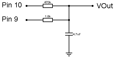

I had a quick search and didn't seem to find anything so I thought i'd have a quick go myself. I wrote it to use timer 1 and pins 9 and 10, at 31.25kHz and 16bit output. Since not all of us have precision resistors, take this example with a slight pinch of salt. I used a 1.8k resistor and a 470k resistor, if this was ideal, i'd being a 1.8k resistor and a 460.8k resistor but this value isn't available to the standard user! If less error is required, a 2.2k resistor and 560k resistor can be used, with perfect resistors, this should give about 0.56% error.
I wrote the code using direct timer and port manipulation for speed. Implementing a 10000-time for loop, and using micros (ensuring to divide the total time by 1.024 as 1micros-uS is = 1.024uS as far as i'm aware), I calculated the direct implementation to take about 1.23uS to execute. Changing all the instructions back to analogWrite and digitalWrite drastically increased execution time to 14.68uS, nearly 12x longer!
I will include a schematic of how to connect the resistors and capacitor. The low pass filter is set at about 18.8kHz.

As can be seen, its really simple and just includes some bitshifts and direct manipulation of registers. Using my multimeter, I can verify that with a wrote value of 32768, the voltage is 2.345v. The supply voltage being 4.69v states that with a value of 32768 (half way), the voltage should be 2.345v. This seems acceptable proof to me!
