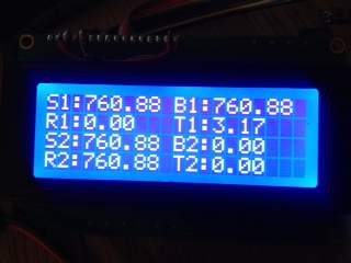

I'm doing a project where I have a 20x4 LCD where I display 8 values next to 8 parameter names which are printed in the program setup. I only update the values and that is done once per secone. The values are floating point numbers (e.g. 345.87) and they range from 3 digits before the dot (e.g. 345.87) to 4 numbers before the dot (e.g. 1503.85).
My problem is that when the values have reached 4 digits and returns to 3 digits, the last character remains on the LCD.
See the pictures attached you I haven't made it clear enough.
My question is if there is a way to clear just a part of the screen, as in characters (3,0) to (9,0) and still leaving all the rest that is already written alone? Or do I have to update the whole display at each update?

Just set the cursor where you want to erase, then print some spaces.
or print a space or two after printing the number.
Set the cursor
Print spaces
Reset the cursor
Print your new number
Don
Thanks guys, I simply cleared the last character for each value area before updating the value.
Now it's good!
