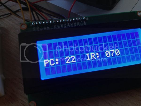

Iv'e been using the Hitachi 20x4 screen for a while now and I'm constantly noticing that the integer variables I am printing are not as they should be. Last night I setup a few lines: temp, humidity, light, IR motion. The one that keeps playing up the most is the Light sensor and IR motion, it keeps adding digits, especially zeros, and does not always look the same as the serial monitor version. I've tried added "DEC" within the print brackets to stop any values from 0 to 9 being single to stop each line from reshuffling, but that didn't do anything to help.
My code so far:
lcd.setCursor(0,2);
  lcd.print("PC: ");
  lcd.print(lightVal);
lcd.setCursor(8,2);
  lcd.print("IR: ");
  lcd.print(irVal);
It always seems to be the the prints that start later on the line i.e. lcd.cursor(8,2), etc.

In your example sketch: are you sure the two values: (lightVal) (irVal) are integers?
Seems like one line is overflowing to the next line.

At the time this was taken, the PC: was 2 in the Serial Monitor, and the IR: was 0.

Can you add a "clear display" line of code and add a delay that is long enough for you to see what is happening? I've had similar problem that something gets written to the display; is PARTIALLY over written; yet some confusing remnants remain.

I agree with CarlW. I have a function that I add to any sketch using LCD.
void lcdClrLine(byte line) {
     lcd.setCursor(0, line);
     lcd.print("                    ");  //number of spaces as characters per line
call this before print to erase what is there and reset to start of line.

lcd.setCursor(x,x) does not clear the line! It only moves the cursor.
