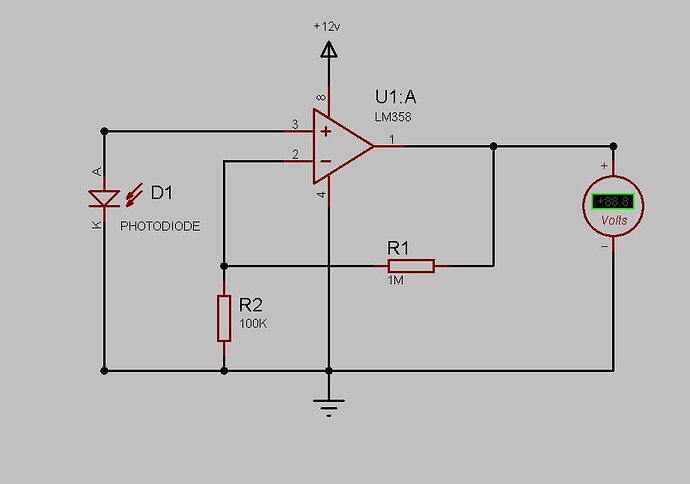

here I am again asking for help: I am trying to read the output of a photodiode (which is inside a laser led) and I am struggling to get the output right. This is the problem: in darkness the output from the photodiode is 240mV (as measured with my oscilloscope) and when i hit it with a laser beam (from an external source) it is 480 mV. I managed to wire up an op-amp (LM358P) and amplify the signal to 2.16 - 4.80V, but it would be useful to have the output range from 0 (or more close to 0 than 2.16V) to 5 V. Is there a way to "shift" the output? (I would not mind to have it from 0 to whatever, as I can always amplify this again to have 0-5)

1/ How can a photodiode produce any voltage at all in darkness ? Could you publish a circuit?
2/ Are you tryng to control the laser power ? If so manufacturers publish recommended circuits. They depend on measuring the current produced by a photodiode.

To measure light intensity with a photodiode, you measure the photodiode current, not the voltage. The best way to do that is with a transimpedance (current to voltage) amplifier.
Here is a good introduction to photodiode amplifiers.
I do not know but that is what I measure
No, I do have a separate current limiter to power the laser (now not connected). I am interested in measuring the photodiode output when the laser is OFF

here is the schematic

I do not exclude that, but actually if I run the simulation of the circuit in Proteus I do measure the same voltage across the photodiode (see attached)

Cloxart - don't do it like that. The voltage of a photodiode doesn't give an accurate measurement of the light.
See page 9 of the NatSemi guide recommended by JRemington in post 2

I think what allanhurst is trying to say that the posted circuit is not a transimpedance amplifier.
The polarity of the diode must be reversed for that, so the diode generates a negative voltage (current) that the amplfier compensates with an equal and opposite positive current (zero volt across the diode).
What is measured is the opamp compensating.
See page 9 of the document jremington posted.
