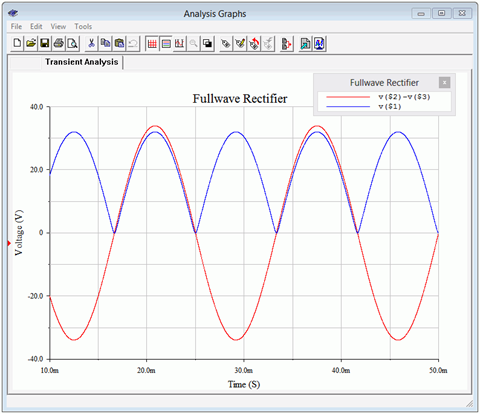

The rectifier will convert the current to something like the blue trace in the below waveforms.
Then R4 and C3 will filter the waveform somewhat to get a kind of average. If C3 is too large you will end up with peak current.
You will need to take a bunch of readings with the A/D and average them to get a stable reading.
NOTE this is not an instrument grade approach, but it will tell you if you are overloading your circuit.
You can get a better average but need more samples if you change C3 to a 0.1µF cap and take enough readings to get a good sample of the blue waveform, averaging all the readings.
R4 in not in parallel with R3 due to C3. However even if it were a 10k // 0.64 ohms will be 0.64 ohms. The change will be in the 3rd or 4th decimal place.
