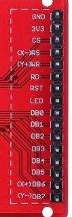

I attach an image of the pins in the TFT display.
I would be very greatful if you can show me the connections with Arduino UNO.
Thank you
Yes, of course you can connect to your genuine 5V Uno WITH exactly the same level shifters that you would use for your 5V Mega2560.

And the other pins of display?Where to connect?
Connect them to the same pins as Mcufriend Uno shields. Then MCUFRIEND_kbv will work exactly the same with your display.
Personallly, I just soldered a 16x1 female header to a Protoshield and wired it to the Mcufriend scheme.
My 2.0 inch display plugs into the socket. The Protoshield plugs into Zero, Due, STM32, Seeeduino, ....
Your 3.0 inch R61509 is just a bigger version of my 2.0 inch ILI9225 display.
David.
Where can i find the connection between my display and Mcufriend Uno shields?
I seached and i did not find something.
Go on. You did not try very hard.
There is little point in worrying about the connections until you have wired up all the level shifter channels.

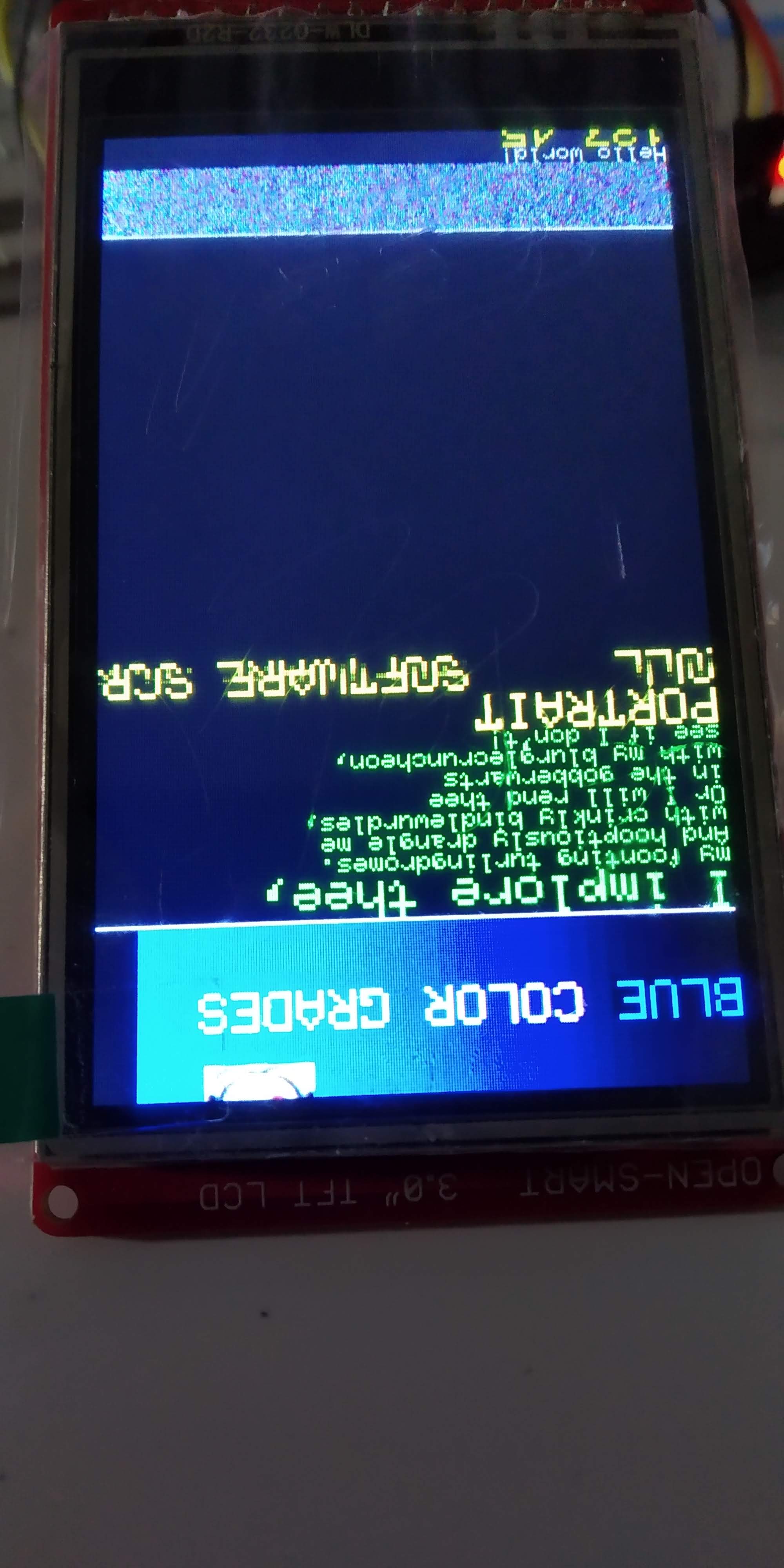

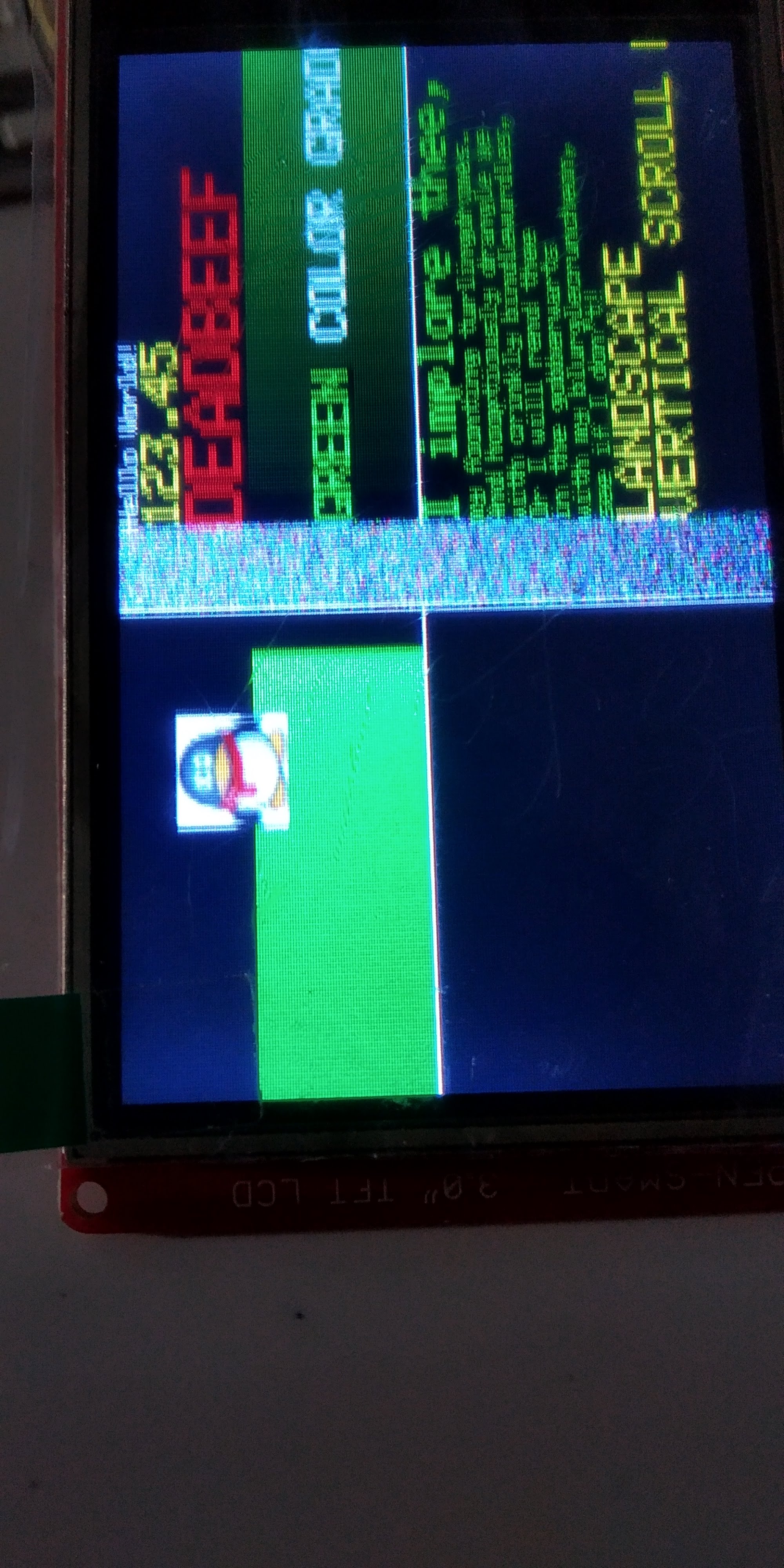

Now i am trying mt 3.0" tft lcd display with David's library.
I managed to make it work but i have some issues running the graphicstest.ino.
I am getting noise line accross the screnn in scrolling text with pinguin.
At the first screen with colors and lines the display works fine.
I attach photos to see what i mean.
Is there any explanation for it?
Thanks.

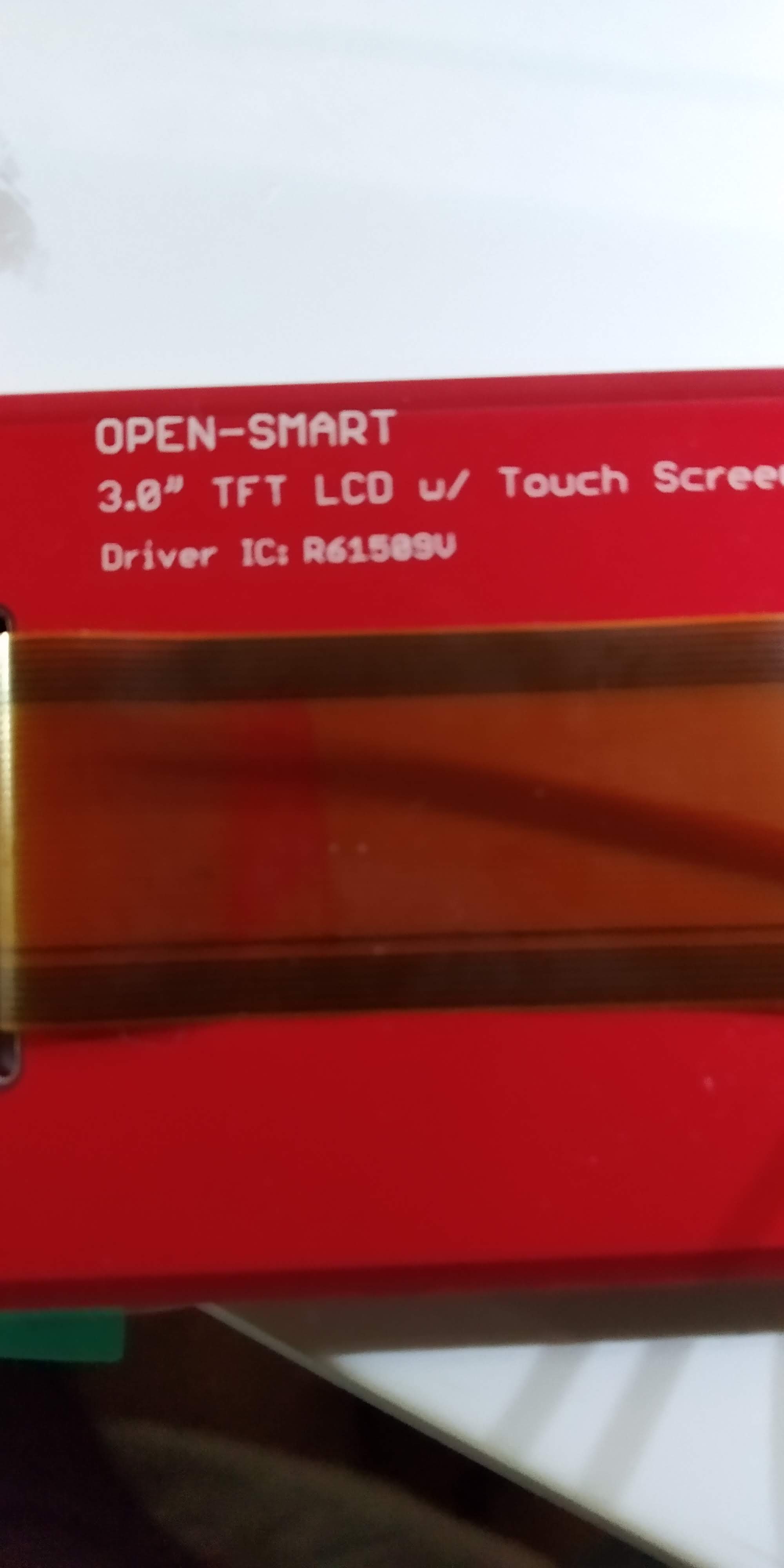

And i attach a photo of the back of my dispaly.
It says that the driver IC is R61509V

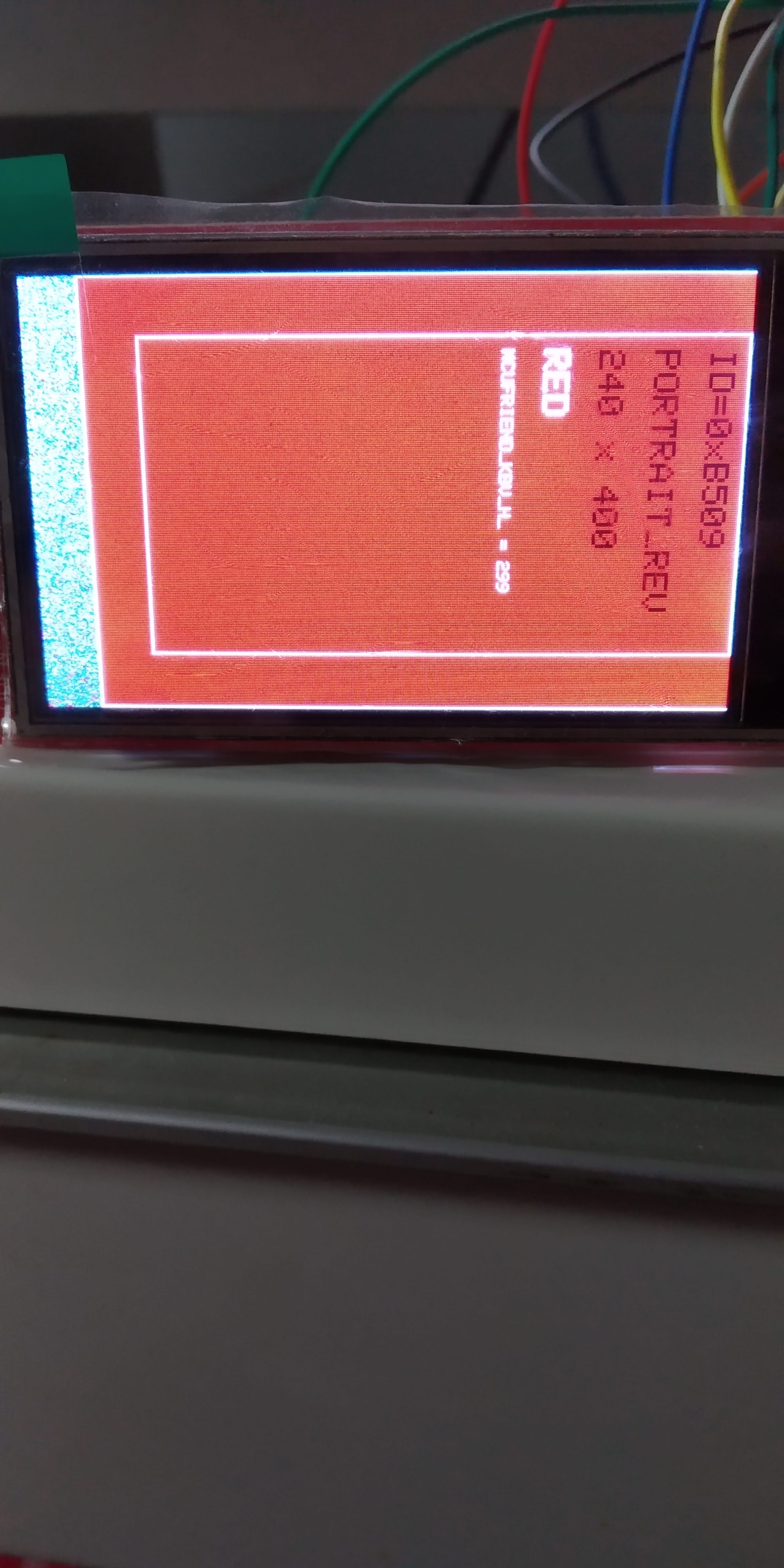

You have a Renesas R61509V controller.
The board is 3.3V with NO level shifters.
The controller is 240x432 but the panel is 240x400. You see random pixels 401-432 when it scrolls the whole screen.
I gave my R61509V shield away. So I no longer have this controller.
I can't use the ILI9327 trick because the R61509V does not support Band Scrolling.
I might have another method but your board is unlikely to survive your cavalier 5V.
