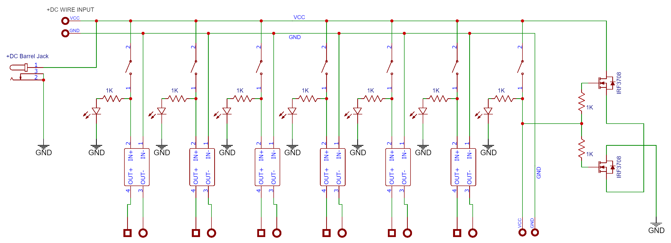

I have an power rail circuit that i will use for powering my breadboard projects with 3.3V and 5V + an direct DC channel that gives the same voltage out as in.
I have looked around for reverse polarity solutions that is bullet proof and found this schematic.
I have search alot, and i'm still some confusing. The one circuit i posted suppose to work and are not made by me. I want to use that circuit (if it works) and the mosfets i have in hand is IRFL3705, IRF3708 and IRLML2502. All N-channel Logic Level Mosfets.

You don't need 2 mosfets and you don't have to use the mosfet in the shcematic I showed you, That circuit works perfectly wel.
How the circuit works.
The PMOS is used as a power switch that connects or disconnects the load from the power supply. During the proper connection of the power supply, the MOSFET turns on due to the proper VGS (Gate to Source Voltage). But during the Reverse polarity situation, the Gate to Source voltage is too low to turn on the MOSFET and disconnects the load from the input power supply.
The 100R resistor is the MOSFET gate resistor connected with the Zener diode. The Zener diode protects the gate from overvoltage.
In your schematic you've drawn is wrong because the VCC can be supplied to the stepdown converters before the mosfet's .

Yes, off course. I know that circuit. This is my backup plan. But i also want to know how i can make an bulletproof reverse voltage protect circuit with N-channel mosfets.
I will use N-channel mosfets because i do not have P-channel mosfets right now. I just need help to make the circuit i posted earlier right, regards to the reverse voltage protection with two n-channel mosfets.
Your schematic is still wrong, You won't get electrified it will just produce the magic smoke signal.
Just give up on your N-CH MOSFET obsession and buy some P-CH-MOSFET'S . Has to us your not listening what we are trying to say,

The idea is there's one for high side and one for low side.
Your trying to use the LOW side in HIGH side you need move it to low side so that no ground (-) get's fed into the board if connected wrong. The OP could not even be bothered to reply to that thread. And I'm not sure why his using to mosfet's in series for either pointless.
Why don't you just use a signal P channel Mosfet it's doing the same job with no voltage loss like the one I posted. If you are getting voltage drop then your not fully turning the mosfet on.
