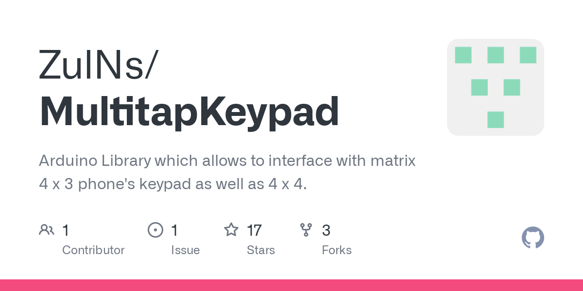

I have not tried this, but this library has popped up in Google;
It quotes that it can detect "multiple keydown".
