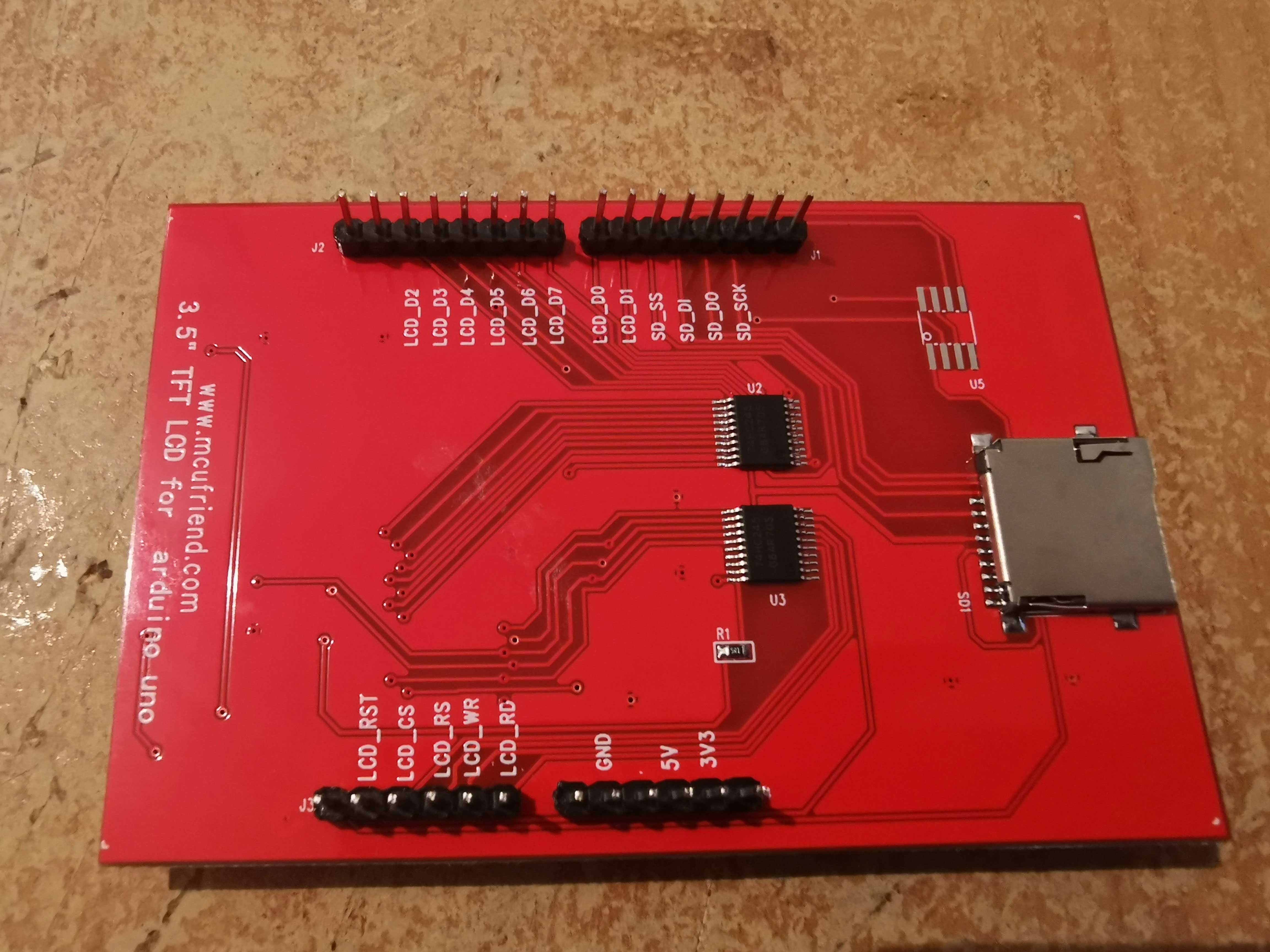

3.5" TFT LCD NOT WORKING - white screen, ID =0x0
Greetings Arduino comunity!
I have bought this 3.5" TFT LCD from ebay, and I can't get it to work no matter what I do, what library I use or what tutorial I follow ... All I have is white screen shining brightly and that's it (mind the attached pictures). It supposedly uses one of these controllers: ili9481, ili9468, ili9488, hx8357 or r61581.
I am frustrated to the point of registering on this forum after 10 years of using arduino, just for this one problem - imagine the pain if you can :D
I really need some help and guidance - I would appretiate any help greatly.
My setup is 3.5" TFT LCD with Arduino UNO R3. I do plan to use this LCD with Arduino Mega mini later, but I would just like to get it working first.
I have managed to do some tests, that would be way more helpful were there any guidelines on how to interpret them, if you are not the guy that programmed them ... But anyway, here are the results:

reg(0x00D3) 01 05 13 01   ILI9341, ILI9488
The ID is probably 0x1301 but I have no idea what manufacturer or part number it might be.
Most 320x480 displays are "MIPI-style". They have consistent User commands. The Manufacturer registers differ.
I suggest that you try forcing some "likely" IDs e.g. all the 320x480 IDs from mcufriend_how_to.txt like 0x8357, 0x9090, 0x9481, 0x9486, 0x9487, ...
Don't worry about mirroring or reversed colours. Just look for a "good steady picture" with vibrant colours. Write the results on paper i.e. any non-White Screen IDs.
Please let me know how you get on.
David.

graphictest_kbv now just gives this error:
Sketch uses 29026 bytes (89%) of program storage space. Maximum is 32256 bytes.
Global variables use 1598 bytes (78%) of dynamic memory, leaving 450 bytes for local variables. Maximum is 2048 bytes.
Low memory available, stability problems may occur.
An error occurred while uploading the sketch
You have misunderstood. Look at setup() in graphictest_kbv.ino
    uint16_t ID = tft.readID(); //
    Serial.print("ID = 0x");
    Serial.println(ID, HEX);
    if (ID == 0xD3D3) ID = 0x9481; // write-only shield
//    ID = 0x9329;                             // force ID
    tft.begin(ID);
You can force an ID by sending your own value to tft.begin e.g.
    ID = 0x8357;                             // force ID
    tft.begin(ID);
Run graphictest_kbv . Do you have a White Screen?
Rinse and repeat with all the other 320x480 IDs in the how_to file. e.g. 0x9090, 0x0099, 0x9481, ...
You don't need to alter any SUPPORT_xxx defines because I think SUPPORT_68140 is on by default.
David.

The sad part is that all ID's were giving me the same result: white screen and test result showing the forced ID, but no other signs of life ...
I suggest that you tell the Vendor that the screen does not work. Ask for a full refund.
If the Vendor can give you a part number for the controller, I can probably get your screen to work.
Without a datasheet I can't do anything.
Please ask the Vendor to find the controller part number. She only has to email her supplier.
But it would save her paying all her customers' money back to them.
David.
David thank you so much for your effort to help me out here, your willingness to help is really appreciated.
I have contacted the seller and have also pasted a link to this thread in my message for them to check it out.
I guess now I have to wait for response from them and hope for the best ... :confused:
I will post any updates regarding this matter here in this thread.
Thanks again!
Seriously. Make it clear that you require a FULL REFUND if the Vendor can not provide a solution.
The Ebay vendor only needs to ask her Supplier for information.

The shield that you bought is WRONG. The backlight is supplied from the 3.3V pin.
A 3.5 inch screen require 50-80mA for the backlight. The 3.3V pin on a Uno or Mega is not specified for this current. And many "Mcufriend pcb" do not limit the backlight current. They get HOT.
I suggest that you choose a "Display Shield" and not a "40-pin display" + "Adapter Shield".
