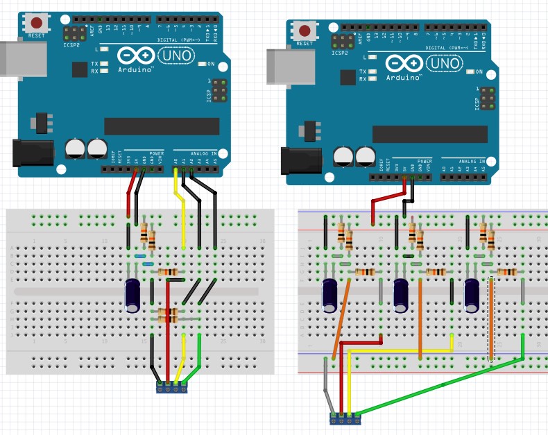

hi guys i need your help i got a 3phate current transformer ZMCt308 for 400amps readings
this CT give 25-100mah output so i decide to add a 18ohms burden resistor to get a 5v output , i been testing my instalation to read the current output with EmonLib
but this CT have 4 cables a neutral and 3 outputs
so im having trouble reading the value from it , and my guess is my conection , what do you think is the correct way to check this,
also do you know if is possible to read the same CT with two devices?
thanks guys in advance

Think about measuring the AC voltage between one lead and the common wire. Then find three transformers that can use that voltage as the primary voltage and give a similar voltage on the transformer secondary winding. Then you have a voltage source the is completely isolated from the other source. With this you can rectify and filter and get a DC voltage you can use with your Arduino.

Its vitally important with a CT that the burden resistor(s) can never become disconnected - immediate
very high voltages could ensue. Lethal voltages are entirely possible, perhaps flashover and fire.
Thus using a breadboard for connecting burden resistors is super dangerous to my mind - the burden resistors
should be securely wired to the CT leads in a rock-solid manner, crimped, soldered, screw terminals, or any
other method that cannot work loose by accident. Only then can you assume the secondary is going
to be safely low-voltage.
A step-down current transformer without a burden resistor becomes a step-up voltage transformer capable
of generating many kilovolts in theory - certainly capable of burning itself out, then shorting internally
and overheating.
I would always recommend getting CTs with built-in burden resistors as these are much safer to work with.

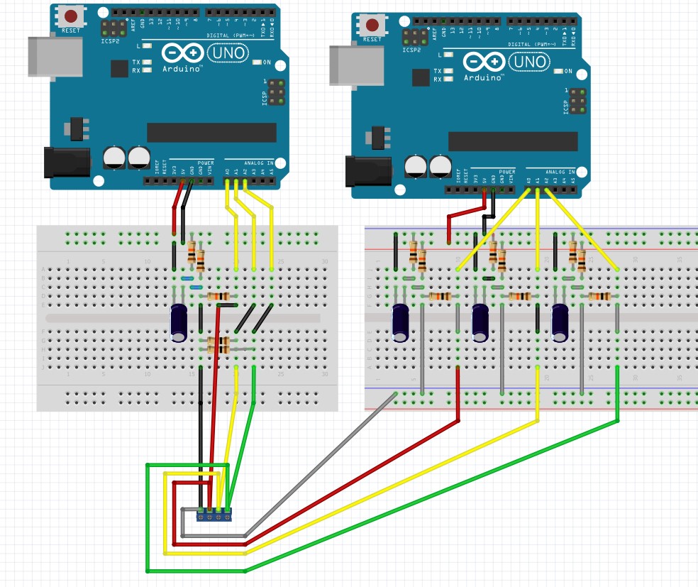

in my system im using a 12 v 6amp supply , with a 5v 10amp steep down there not a neutral on the input is a 3phase delta type,
i really need to get this sort it , but i cant figure out the circuit for the CT

...but this CT have 4 cables a neutral and 3 outputs...
Seems that you only need one mid-voltage circuit (two equal resistors and one buffer cap).
With the common of the transformers connected to that point.
And three burden resistors between each 'hot' winding to that common point.
Then connect those three 'hot' points to three analogue inputs.
Leo..
leo can you write a diagram , to complete get your information im really sorry about that leo but my brain is not working after 2 days fighting this one
Don't think I can explain it more clearly, and no time to draw a diagram.
The Arduino can only measure positive voltages, so the common wire of that transformer needs to be lifted to mid-voltage (~2.5volt) to prevent the AC signal from going negative.
That's why you connect that common wire to a 10k:10k voltage divider (with or without the 10uF smoothing cap).
The three other/hot wires from the transformer connect to three analogue inputs.
If you also have to add burden resistors across each of the three transformer windings depends on if those burden resistors are already buildin or not.
Leo..

If the current transformers are already in circuit, then the burden resistor are already present, so you do not need to add them.
If you do then the readings of the other monitor will be affected.
Unless you are trying to make a replacement unit?
Can you tell us your electronics, programming, arduino, hardware experience?
A proper schematic, not a fritzy, labeling the pins and terminals you are wired to.
