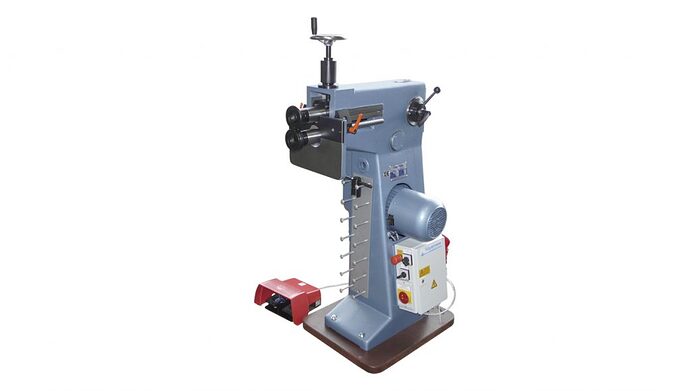

Machine runing 3 phase motor 480v. Picture is attacked.
So i upgraded manual part with 1 42 stepper motor and Arduino mega 2560.
Everything is wired properly only i have problem with USB communication when i press
footswitch (turning 3 phase motor on). important thing is:
  • If footswitch not touching machine,if is on floor then arduino losing communication with usb pc port.
    (arduino working, only no communication and i have to reconnect usb cable)
  • If i remove gnd wire from arduino then no losing communication with usb port.
  • If i make footswitch to touching machine i don't have any problem even arduino gnd is connected.
Also i don't have problems when arduino is powered by external power supply and footswitch is on floor.
But then i don't have communication with pc and i need pc to controll arduino by my visual studio
program.
So somthing is about arduino ground.Nema steeper motor is wired on same power as machine.Only 1
phase,neutral and eart (220v). Arduino board is in plastic electric box.
Tested with 2 arduino boards and 2 pc but i get same problem.
Sorry for may english and thank you for reading a topic.

Thank you Tom.Hire is simple wiring.I will tell you what is strange.
it doesn't matter do i connect Stepper or not.
I take only arduino board (in plastic electric box) without wiring stepper driver .When i connect arduino gnd pin on machine box (made from metal ) and press footswitch, arduino losing communication with port (no restarting arduino board).
If i connect led and write simple code arduino working.Only brake communiation with pc.
But when i make footswitch touching metal of machine,everyting working without problems for ever.It is so strange.I will try tomorrow cut + and - wires from usb cable.Make like Data only cable to send and receive data and i will power arduino by external 12v power supplay.
You need to check ALL of the wiring in the machine, it sounds like there is an EARTH connection missing.
Make sure that the machine chassis is EARTHED and that the case of the foot switch is also EARTHED.

As others have said, check the earthing of the machine first. When you know that is ok and if the problem persists then I would suggest you check carefully how the earthing of your pc is arranged.
If the pc is a laptop then the power supplies for them are often not explicitly earthed at all. If you have a CRO handy, try looking at the 'earth' connection of the machine when you start the motor. You may be surprised at just how much noise is there.
If you don't have a CRO then a DVM between the machine earth and the shell of the usb cable (disconnected from the arduino) may give you some idea of any problem there. Try low range AC settings first.
My thinking is that the noise generated in the earth circuit is coupling into the usb in common mode and overdriving the usb interface.
Let me know how you go and if the pc is a laptop and if it has an earth pin.

I checked EARTH and all wires with digital multimeter .Everything is fine Tom.
All wires and machine are earthed.
I tested 3 machine and i can tell you:
  • i have 2 same machines with magnetic conntactor ,for driving motor and i have problem with them.
  • and third use 3 phase inverter to drive motor, that working without problems.
PedantEngineer i will tray tomorrow this with pc. I used laptop,so that can cause problem.

So much noise is there and if lift foot switch top of machine then no noise.What you think if i order bluetooth serial communication module or do you have some advice what is best way to avoid a noise.

I tested 4 days everything and problem is in usb interface on all laptops if is windows installed (if is linux then no problems).
And if is desktop pc everything is perfect + usb cable with ferrite on both side.
As PedantEngineer said:
" My thinking is that the noise generated in the earth circuit is coupling into the usb in common mode and overdriving the usb interface."
I hope this will help to somebody.Everyday we learn more :slight_smile: :slight_smile: :slight_smile:

It is curious that the operating system makes a difference but not totally surprising. If I am right (as you suggested I seem to be) about the noise issue then it is a matter of how the OS handles errors and clearly Windows doesn't do it as effectively as Ubuntu in this case. Either way, you have a noise issue that needs sorting out.
Is it possible in your project to isolate the PC using opto couplers for example? I'm thinking that the noise is likely to be far too big for an RS485 type interface and fairly high frequency as well (sharp edge signals even at low repetition rate will mean high frequency components in the spectrum). So the high CM voltage tolerance as well as the high dv/dt rating of an opto might be your best bet. There are also 'digital isolators' around that might be the ticket and they make to job sooooo much easier. Have a look at ADuM7240 and ADuM7241 for example. They might be expensive but if they prove the point then you can concentrate of a cheaper solution knowing you are working in the right direction.
I hope that helps and I'm not too late with the advice.
PE.
It may be best to invest in an Opto-Coupled Isolated USB to RS232 cable.
