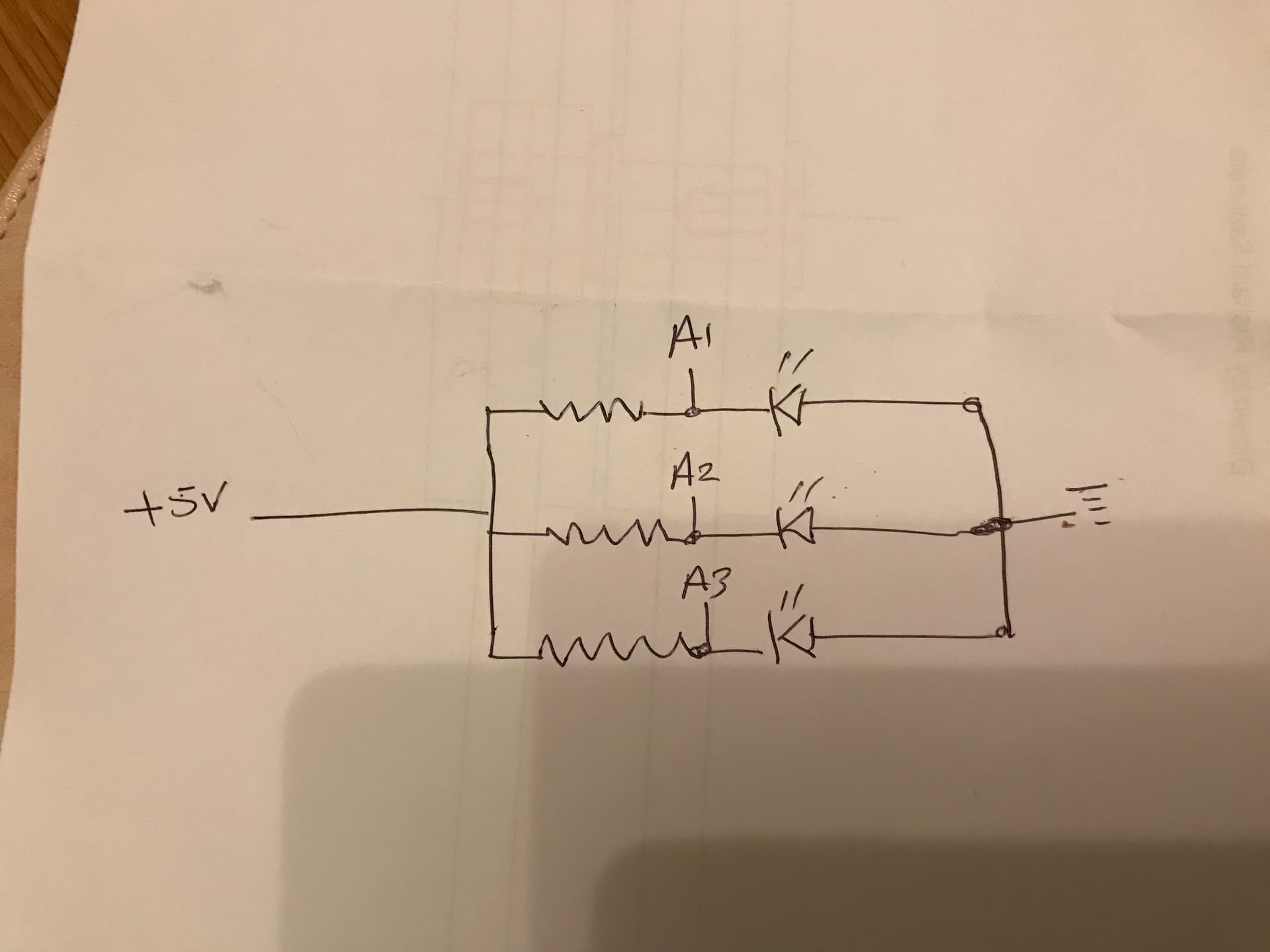

The programming side works however I have 3 photodiodes one each on pin A1, A2 and A3.
Using 1 photo diode works well.
5 v to one side other side to a 330k resistor and the resistor to ground, the diode to resistor intersection goes to pin A1.
Readings in the range 3 to 1022, which I am happy with.
Now when I add 2 more same arraignment except the out put goes to A2 and A3 the readings go in the range of 20 to 163 max.
Ok I think it is a resistor problem but I am out of my depth.
Any help would be appreciated.

If the photodiodes are identical, you may have installed photodiodes 2 & 3 backwards. In any case, the voltage divider circuit (shown left in the figure below) will not work well with the Arduino ADC, and when switching ADC channels, you must throw away the first ADC result, and take the second reading.
The circuit on the right will work much better. Use just about any low voltage, rail-to-rail op amp (the LM358 is not rail-to-rail).

What do you mean, "in parallel"? Post a wiring diagram.
Hope that works (the picture)
Should be OK, if you actually do have the diodes connected the right way around (as drawn). Except that the diode impedance is far too high to be connected directly to the ADC input.
Are you throwing away the first measurement, after switching ADC channels?

Hi, thanks for the help, new day and a clear head!
Went back to first principles 3 new Photodiods, resistors, bread board and jump leads.
Made it up and it worked so used the assembled bits!
Discovered that one faulty PhotoDiode and a OC resistor.
