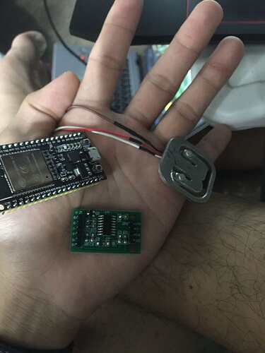

3 wire bathroom load cell connect to HX711 and to esp wroom 32
My thesis project is to make a water bottle mount that measure the mL inside of a 32oz. For that, is it possible to connect 3 wire load cell to HX711? Usually a single load cells (the rectangular one) have 4 wires: White, black, red, green.

Yes it is. However the loadcell you show is probably not sensitive enough.
1 liter of water weighs 1000g so for maximum resolution you would a loadcell with a maximum in that range. The one you show, I believe has a max value of 50000g and will not give you the resolution you need.
You need to find a different loadcell

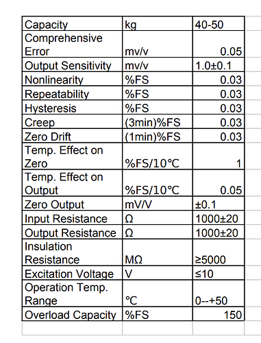

There aren't many good datasheets for those three-wire half-bridge load cells, Sparkfun Load Sensor - 50kg (Generic) - SEN-10245 - SparkFun Electronics has:
The trick is that a half-bridge (half of a Wheatstone Bridge) like that is just a voltage divider that changes it's middle voltage 0.1% when you load it to the full value, (+0.005V on the HX711's 5V excitation voltage) You need another half of the wheatstone bridge to provide a reference value for the HX711 to measure that 0.1%, of change against. or the other half of the bridge can use another gauge as a dummy, or a potentiometer you can adjust to match the 2.500V.
For the milliliter sensitivity range you are talking about, 1ml = 0.001kg and 0.001kg/50kg=1e-6 times the full-scale sensitivity of the gauge gives a signal of 0.005V=100nV/ml, which is pretty tiny. But the HX711's 24 bit ADC range and x128 amplifier advertises 2.5V/128/2^23=2.3nV resolution, so there's a chance.

Yes. With one half-bridge, you only have one input to the HX711 inputs. For example you have A+, and you need a reasonable reference signal to put into A-.
Yes, but you should make sure the selected resistors are balanced enough to match your cell. Some folks use 10% tolerance resistors and have troubles when the difference between the load cell's voltage and the resistor's voltage divider voltage is >20mV. Which, with the x128 amplification, pegs the HX711 scale at +/-2^23=8388608 You should use the more expensive 1% resistors, or a pot, or a couple cheaper resistors and a pot to make the reference voltage. All will work.

A 5kg load cell would be a bit simpler to wire up, and instead of a 100nV/ml signal, it would have a 1000nV/ml (1 uV/ml) signal for the HX711's and likely be 10x more accurate.
Another issue on using the bathroom half-bridge cell is that you have to make sure the center arm can bend like a sigmoid curve with load -- support it around the rim, not anywhere in the middle and concentrate the force on the nib in the center on the wire side.
If the cell isn't supported properly, the center bar won't bend well, and the strain gauges won't stretch predictably.

Another issue is that you have a HX711 board for 5volt processors.
Only Sparkfun sells HX711 boards that are suitable for 3.3volt processors, like the ESP32.
Leo..

Yes it will but as @Wawa pointed out, the HX711 has 5V signals and the ESP can only connect to 3.3V signals.
The simple solution is a 2-resistor voltage divider, to drop the 5volt-logic data line to 3.3volt.
  1. 1k resistor between HX711 data out pin and ESP data input.
  2. 2k2 resistor between ESP data input and ESP ground.
    Don't use one on the clock line.
A better solution is to use a Sparkfun HX711 board, which has a 5volt supply pin for the load cell and a 3.3volt supply pin for 3.3volt logic. Or you could modify your board if you can solder. Schematics are on the Sparkfun site.

I was trying this load cell to make it into a full bridge (from the first comment's suggestion)
it works (i think, because whenever i put a load into the cell, the reading changes) but not really accurate as it seems, and you said that this type of HX711 has 5V signals, but ESP only connects 3.3v, thank you for that.
On those cells you really have to support them around their outer rim and make sure the inner 'E" is not supported. In the photo, if you think of the shape as a "E3" with the "E" kind of inside of the "3". The E part must not rest on anything so the bar in the center bends freely into a sort of an s-shaped "____/ ‾ ‾ ‾" bend when you press on the nubbin. If it has any support, you'll get terrible repeatability.
