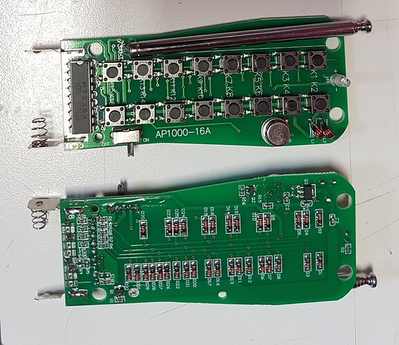

So I got the RCSwitch library to work after I figured out that the Leo uses a diff IO for Interrupt 0. After opening up my remotes and reading PDFs, I found out my transmitters use a PT2264 chip PDF with a APRXB12 receiver board (SYN470R chip) PDF

Two more pics

It is the common protocol.
I think that the PT2264 and PT2262 are almost the same.
Do you understand the protocol ? The chip has tri-state pins, they can be high, low, or in the middle. The burst of data is transmitted a number of times, to be sure that the receiver got it.
