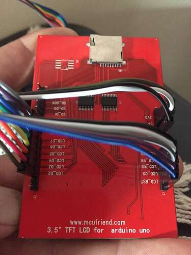

Hello David,
To get back to the annoying topic of running TFT's for UNOs on MEGAs. I'm doing a little project where I was supposed to use this TFT with an UNO - but then the need to use softwareserial popped up - now the UNO is out the window, in with the mega. I connected the wiring as you mentioned earlier in this post and the display works like a dream, as quick as on the UNO. Problem is the touch screen. The touch screen works well on the UNO but no response on the MEGA.
Please tell me there's something I can do to get the touch screen going on the mega...
RM68140 320x480 ID=0x6814. Picture below.
Think about it. The calibration sketch is designed for the shield. So it only diagnoses data pins on 2-9 and A0-A5.
If you have moved data pins to 22-29 on the Mega, you need to map the Uno diagnosed pins.
E.g. if XP, YM were diagnosed on 6,7 they would now be 28, 29.
It looks very painful to connect lots of jumper cables. I would make a proper Adapter with a Protoshield.
If you map data to 22-29 and SD pins to 50-52, the TFT, Touch and SD will work fast and efficiently.
David.
