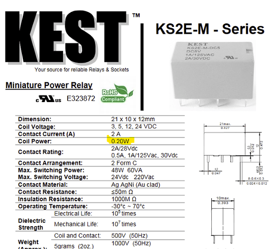

It's provided by the Arduino I/O pins. I'm not saying it's an appropriate thing to do... posting for clarification.

If that's the setup I found this
So operated at 5V pins the current would be 0.20 W / 5 V = 40 mA if I'm not mistaken. That is close to the very limit. Hope the relays know about that.

40mA, that's the maximum value where operating at too long at can damage the controller.
Use a 20mA maximum for the safe operating maximum.
Agree, in this specific case the relay may be supplied for a short time (here it says 3 sec) ...
But anyway, I would go with a PCB relay (usually with optocouplers), transistors or the ULN2003A.
Show us the code you have written so far.
I would be nervous about driving them directly. Even for 3 seconds...
