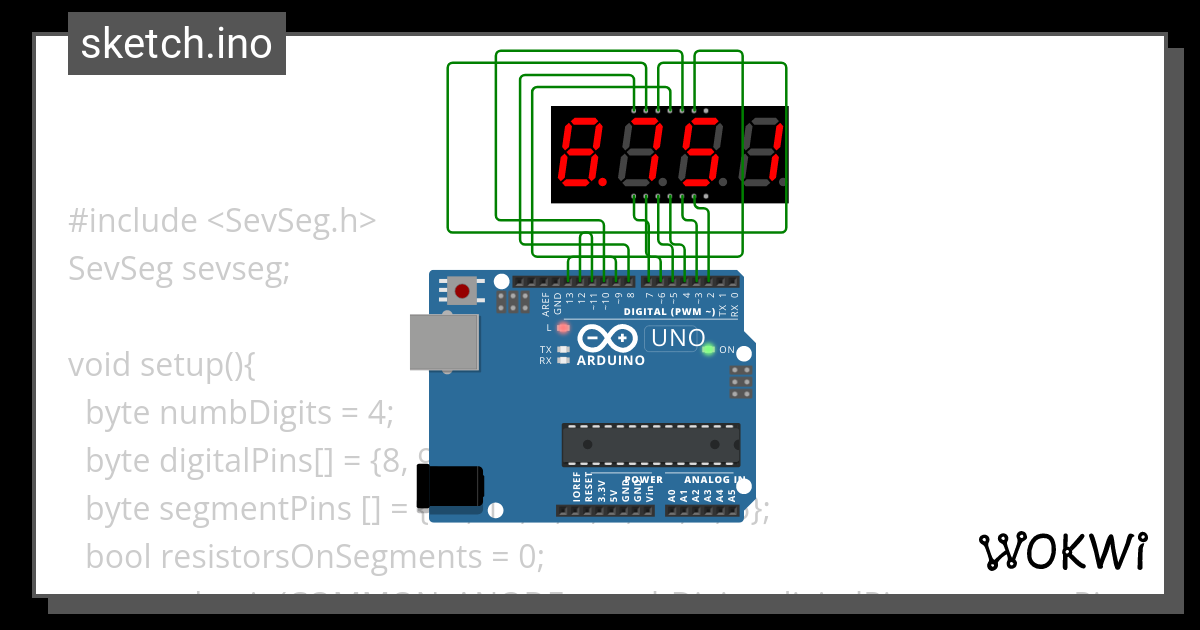

This code does not compile correctly because it has several typing errors.
#include <SevSeg.h>
SevSeg sevseg;                                    // Instance  (sevseg) use lower case
void setup(){
  byte numbDigits = 4;                           // <<<<< letter b   may be numDigits
  byte digitalPins[] = {2, 3, 4, 5};
  byte segmentPins [] = {6, 7, 8, 9, 10, 11, 12, 13};
  bool resistorsOnSegments = 0;
  sevseg.begin(COMMON_CATHODE, numDigits,
digitPins,                                      // Not digitPins  correct digitalPins
segmentPins,
                        resistorsOnSegment);    // < Missing "s" at name end
  sevSeg.setBrightness{90};                    //   <<  ---- not {90}  correct (90)
//                                             // not S uppercas   correct  sevseg.
void loop(){
  sevseg.setNumber(8751, 3);
  sevseg.refreshDisplay();
See this simulation:
I used different pins than yours but that's not important and I no have use resistors.
After all, it's just a simulator and the LEDs don't burn out.
