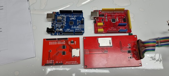

I'm after a successful sketch of power buttons on a 2.4-inch display panel
2.4 "TFTLCD SHIELD (ili9340) mcufriend library
Runs on UNO board. Excellent
Runs on the Open Smart UNO R3 Air board. Excellent
Now I thought to myself that it is possible to run on a 4 "TFT touch screen
(4 "TFT SPI 480x320 V1 / 0 RED)
But fails, it is clear to me that I do not understand and can not define what each PIN its name, what each PIN role (who is PIN DATA?) What is the function of resistance of a screen? Who PIN analog? Who is PIN Digital?
I can understand that a 4 "screen works on 3 or 4 PIN DATA, but it is not defined who are out of 6 available (available - D2, D3, D4, D5, D8, D9 - on a 2.4" screen) Who are the four who transfer DATA to CHIP ST7796S? (From ARDUINO to a 2.4 "screen I can use for a 4" TFT?
Is it SDI (MOSI), is it PIN READ? Or WRITE?
Who are 2 PIN Digital (touch screen voltage?)
Just too complicated, I do not want to give up on it - I am drawn in like a swamp and can not let go until success.
Please help with my project. Thanks for any kind of help.

MCUFRIEND_kbv works with Parallel Shields. The shields have level shifters.
Your SPI display requires 3.3V level shifters and a different library. I am fairly certain that the Air board has a slide-switch to select 3.3V logic.
You can try my Adafruit_ST7796S_kbv library from Github with your SPI display.
David.
hi David!
I took a picture. Front and one rear.
Indeed, a switch in 3.3V mode.
I'm going to try with the library (Adafruit_ST7796S_kbv)

The 4.0 inch display in #3 looks like ST7796S SPI display.
Install Adafruit_ST7796S_kbv from my GitHub.
Switch "VCC Select" to 3V3. Connect your Red ST7796S SPI display:
VCC to 5V
GND to GND
CS to D10
RESET to D8
D/C to D9
SDI to D11 (MOSI)
SCK to D13 (SCK)
LED to 3.3V
SDO to D12 (MISO)
Run the examples from Adafruit_ST7796S_kbv
unfortunately!
All connections were made as you instruct me
All three examples were tried
Without display
Only rear light works
Is there a possibility that four damaged screens I buy from the Chinese supplier? (From my experience - the answer is yes.)
For a 2.4-inch project I bought 10 screens, 6 were damaged there.
Thanks for the time being, I will get back to you with results after ordering more screens
