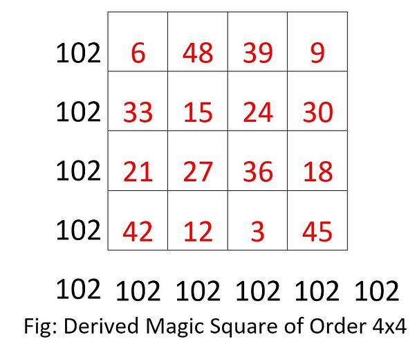

For which constraints? Solutions to the 4x4 puzzle can have different totals, but all column, row and diagonal sums have to be equal.
Those of the recent discussion mentioned in my post, which was about the classic traditional 4x4, using the digits 1 to 16.
