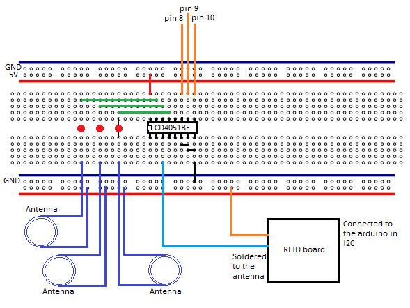

I'm trying to multiplex the antenna output of the RFID board I have to multiple antennas so I can determine which one is being read. Of course I can have more readers but I'm trying to save money.
I can get the multiplexer working with just normal voltage applied to the input with the LEDs turning on at their designated slots. Currently I have it changing the output every 100ms.
When I try to connect the antenna from the RFID board the LEDs (I'm only using them to test but not in the final design) they no longer follow the sequence but twinkle. They mostly stay on with a slight dimming every now and then but not in the correct sequence.
I can get multiple external antenna working fine without the multiplexer but of course I can't then tell them apart.
I'm quite new to antenna design so have no idea why or what is happening here.

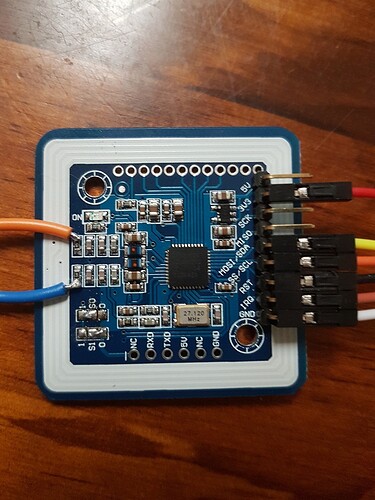

Attached is a sketch of my wiring and a photo of how i connected to the antenna on the RFID board.
Any help would be greatly appreciated.

It's like the 4051 stops working correctly and stops switching to the different outputs when the antenna is connected. I have no idea why as i though each output is isolated?

Can you post a schematic diagram, a complete one? I'm not sure I understand what it is you are trying to use the 4051 to switch.

Here is an updated schematic.
Im trying to have it cycle through the external antenna so when something is read on one I will know what antenna was active at that time so I know where the card was read.

That's not a schematic.
But I'm still 99% certain it won't work with 4051. It's not an rf frequency component.
Yeah sorry fairly new to this and the best I can do.

What sort of RFID reader do you have?
It matters because they work at vastly different frequencies 125KHz and 13.5MHz.
Nether will work with a 4051, just look at the data sheet. A 125KHz might work with a relay.
I have a 13.56MHz RFID Reader, by doing some more research it looks like it won't work with the 4051.

The voltage on an antenna an easily reach over 100V as it is a coil at resonance. They can't handle that sort of voltage.
The antenna is three loops of 0.12mm 8 strand wire at 60mm diameter. The voltage increases to 3.6v from 2.2v and is grounded to the arduino.
This antenna work as well as the one built into the board based on distance.
All I'm trying to achieve is to be able to switch between multiple antenna loops.
