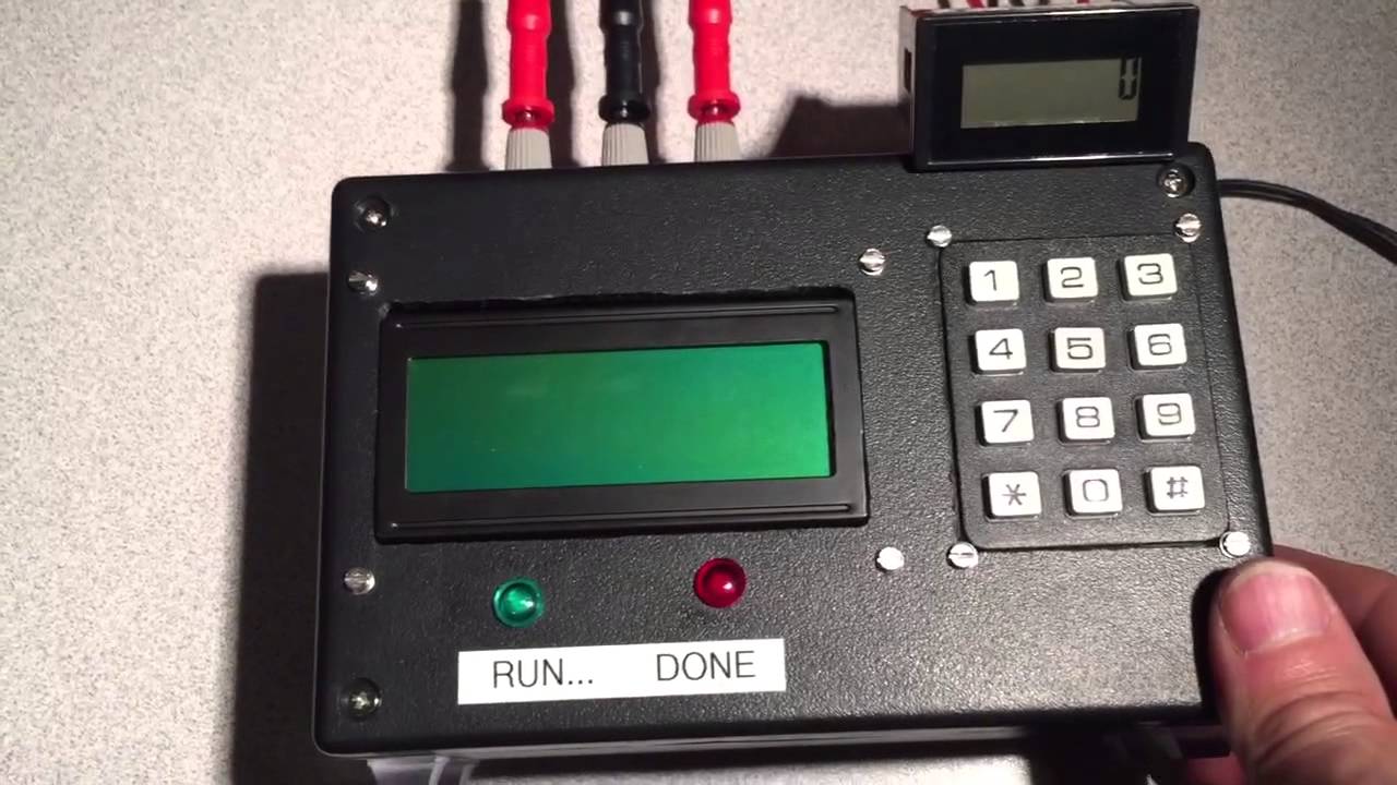

I resolved this query. Consider it closed.
Final project completed:
