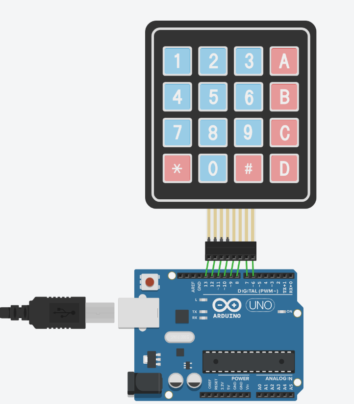

4x4 Keypad on tinkercad always gives zero value no matter what I press
Image of project:
my code:

They can’t all be inputs, 4 must be outputs.

You need to output a signal in order to read which key is pressed. So if you make the rows outputs and columns inputs, then for each row you scan the column. If you get a high signal at y-row for x-column then a key was pressed and all you need to do is figure out which key it was.

I have had that exact same keypad for about 4 years and never got around to using it. I had nothing better to do so I wrote some code to test it. This works correctly on an Uno R3. The wiring is exactly as shown in the image in post #1.
// Define pins connected to keypad
const byte columnPins[4] = {6, 7, 8, 9};
const byte rowPins[4] = {10, 11, 12, 13};
// Define characters for each key
const char keyChars[4][4] = {{'D','#','0','*'},
                             {'C','9','8','7'},
                             {'B','6','5','4'},
                             {'A','3','2','1'}};
  // Set column pins to inputs with pull up
  for (byte column = 0; column < sizeof(columnPins); column++) {
    pinMode(columnPins[column], INPUT_PULLUP);
  // Set row pins to high outputs
  for (byte row = 0; row < sizeof(rowPins); row++) {
    pinMode(rowPins[row], OUTPUT);
    digitalWrite(rowPins[row], HIGH);
  // Check each row to see if a key is pressed on that row
    // Set the output pin for this row to LOW
    digitalWrite(rowPins[row], LOW);
    // Check each column of this row for a key pressed
      if (digitalRead(columnPins[column]) == LOW) {
        Serial.println("Key pressed row=" + String(row) + " column=" + String(column) + " = key " + String(keyChars[row][column]));
    // Put the output for this row back to HIGH
  // Delay to stop serial monitor getting full of text for 1 click
  delay(250);
When a key is pressed it prints what key has been pressed to the serial monitor. This output is for key presses on key '1', then '5', then '9', then 'D'
Key pressed row=3 column=3 = key 1
Key pressed row=2 column=2 = key 5
Key pressed row=1 column=1 = key 9
Key pressed row=0 column=0 = key D

This works, thanks. I still don't really understand it but I will study it more later.
