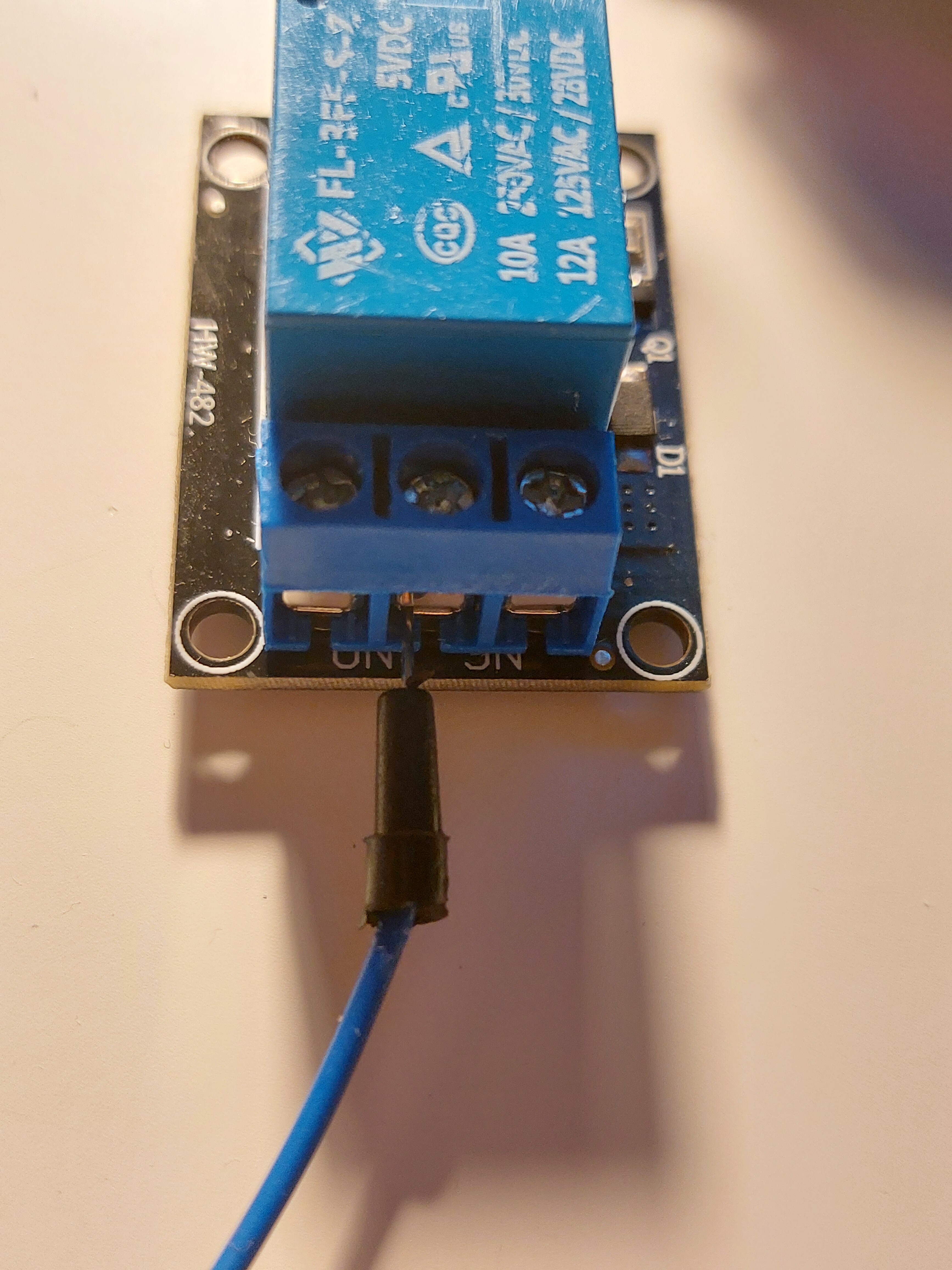

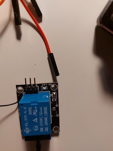

so far, I have not see the LED on the relay module glow.
Can you take a close up of the logic side of the relay ?
Relays work, but led doesn't glow
Emm, whats is logic side of relay?

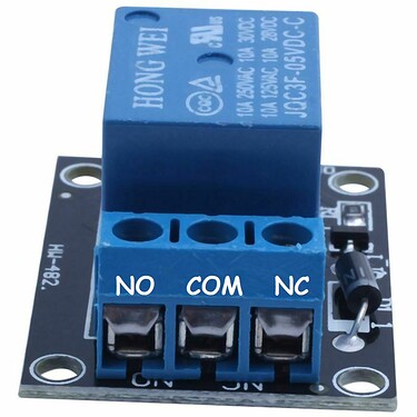

relay module has two sides.
the NO/COMM/NC is the 'power side' or output
the signals and relay power is the 'logic' side.
the LED on the relay board is part of the logic circuit for the OPTO isolator.
if that does not glow, then the power is not enough to get it to glow.

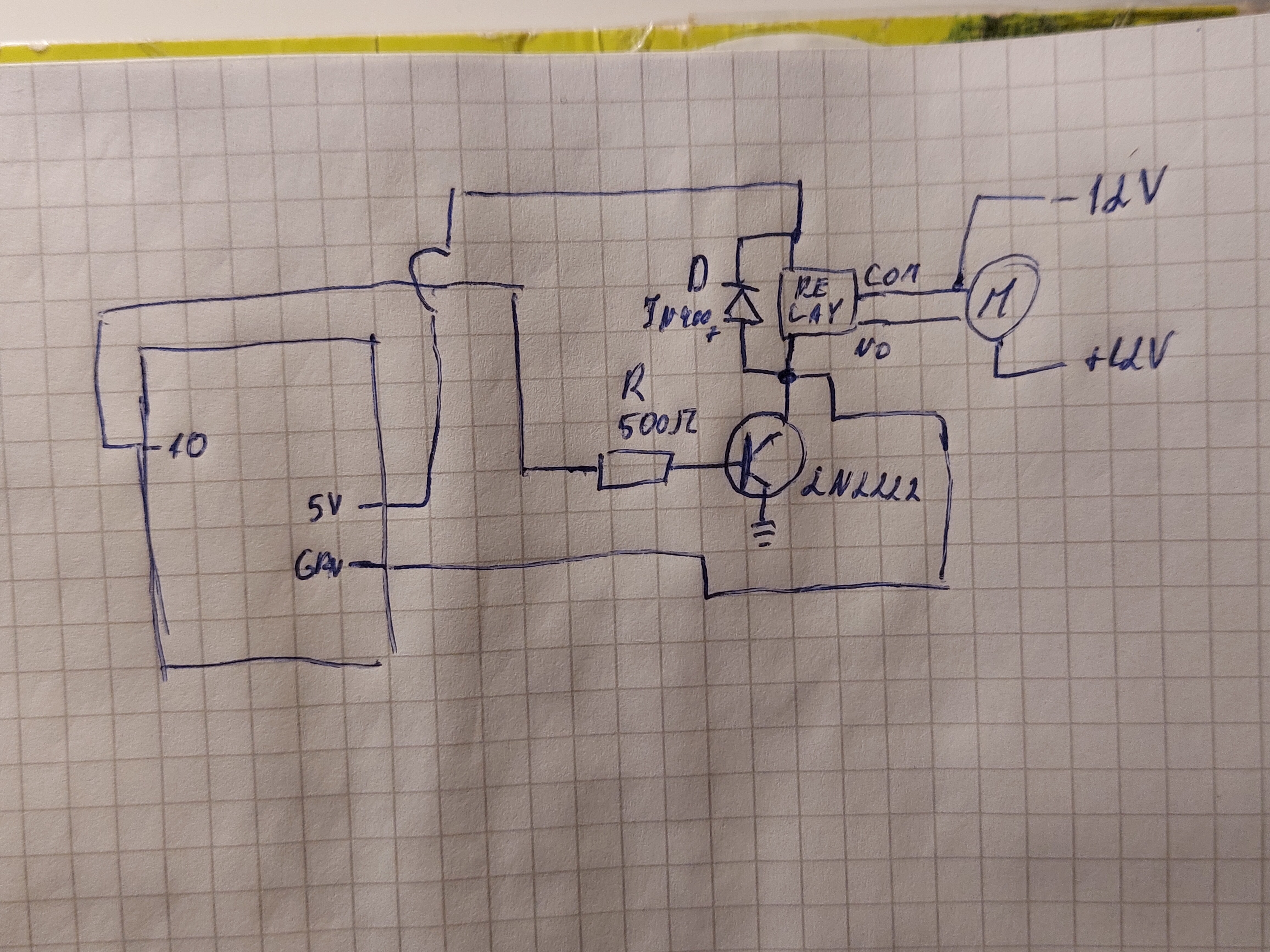

PLEASE get out pen(cil) and paper and draw your circuit.
Include.
  • Labels on all connections.
  • Show ALL power supplies and how they are connected.
  • Label ALL component and their leads, eg 2N2222.
  • Make sure you show and label ALL the relay PCB terminals.
Then post a picture of it.
PLEASE do not use Fritzy CAD, your hand has all the component symbols you need.

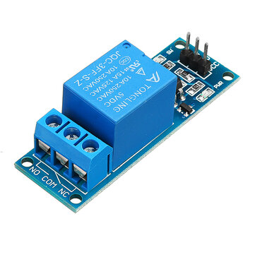

there is a close up of a similar looking module from banggood
with the output side on your right
inputs on the left,
the connections are written upside down
but are
VCC
GROUND
signal
I like to use pen :smiley:
I case can't real my handwriting, Transistors 2N2222, resistor 500om, diode IN4007

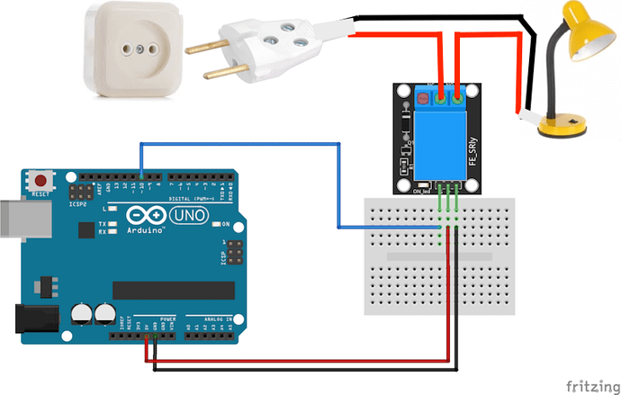

I know I'm posting a Fritzy, but this was on the site linked to the relay.
Replace the power lead and lamp with your power supply and pump.
Use COM and NO terminals on the Relay.
Unfortunately this bit of description defies belief.

holding the relay with the pins on the left and the screws on the right.....
is this correct ?
top pin = signal
center = Vcc
bottom = Ground
which is your Vcc is connected to :
Vin ? or the 5V
I would say to connect things back up with the
Vcc to a 5 volt source and like someone had asked, to connect your meter to that and watch what happens when you activate the relay.
connect 12 V to the motor
motor ground to common
connect NC to the 12v ground rail.
the pump should spin until you activate the relay.
Once you connect to 12v the pump should spin, proving all the power is working
changing state of the relay would open the circuit and shut off the power.
once that works, move the ground to the N/O connection. try again
Images from linked site.
Tom.... :grinning: :+1: :coffee: :australia:
Relays center Vcc is connected to arduino 5v
the relay notes say the LED is for power indication.
but the schematic shows it as part of the signal line.
Have you tried the connection in post#34?
