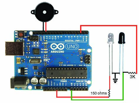

I know it says that on the page OP linked, but all the ones I used before are opposite: the dark one is the led and the clear one the receiver.
Well it's a bit special: The receiver should be reverse biased in a divider and the signal read at the mid-point:
source
no.
and wiring can be inverted.
Don't contradict me when I'm saying for a fact, that (and I quote) "all the ones I used before are opposite", note the emphasis, and here's a photo:
so good photo. of course i am convinced.
I don't give a rat's if you're convinced or not; the fact is that for the ones I have used before, the dark one is the light. I was merely making that point. I am not saying, nor am I saying, that the web site is wrong, nor am I saying you're wrong.

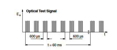

Indeed. I've used a TSOP4838, which is designed for compatibility with TV remote controls, in a beam break application. There I had to modulate the beam at 38kHz and send 600us carrier bursts each followed by something like a 600us pause. The data sheet states the relationship between the bust length and minimum pause. The reason for this is that any continuous signal is treated as interference (as say from a fluorescent light) and tends to be filtered out.
from https://www.mouser.ch/datasheet/2/427/tsop48-1766935.pdf
Close...
TSOP receivers have AGC (automatic gain control).
They turn down amplification until no signal is received, to block out background noise. Short powerful pulses (remote) can still come through.
