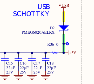

I'm new to Arduino and am using the R4 to power some low voltage breadboard stuff. I picked up an R3 at the same time. It seems like the 5V out is consistently measuring about .3V less on the R4. Do I have a faulty board or is there a reason for this?

I haven't looked at the R4 schematics but on the R3, 5V is not directly-connected to 5V USB power. I think there's a diode and/or MOSFET and it wouldn't be unusual to get some voltage drop.
The 5V from the USB connector is going through a diode to the 5V pin.

So I'll never get to 5V without something else boosting it in between? I don't see it being an issue, I just wanted to make sure what I have is standard. Thanks.
It is standard.
If you want 5.0V at the 5V pin, then you have to apply a voltage of 6 to 24V to the the DC barrel jack or the VIN pin.

The main purpose was to figure out why R3 read 5V but R4 did not. As I mentioned I'm new to Arduino (and DIY electronics in general) and had no idea there was a published schematic I could read. The diode makes sense. Input voltage and meter accuracy have no play here because all I want is the measurement relative to the R3. Again new to it. Just wanted to make sure I had a functioning unit.
The 5V pin should measure at least 4.7V and this is due to the voltage drop accross the D2 diode.
