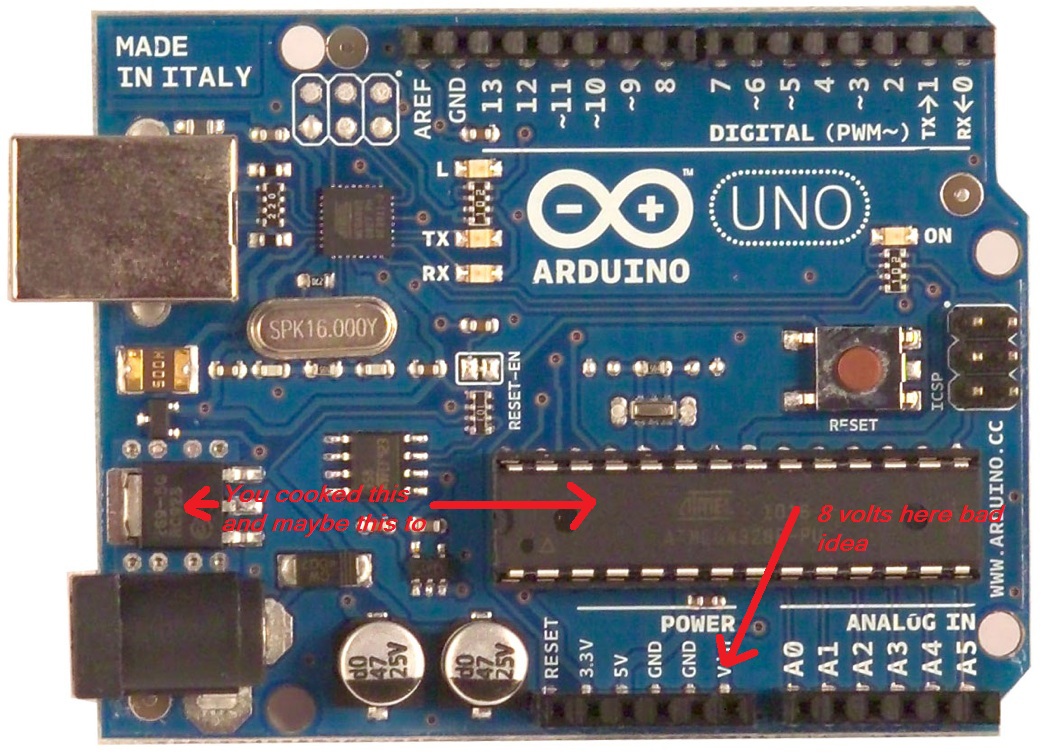

I am trying to reverse the polarity of a motor using 4 little 5v SPST reed relays (because they're quiet). I built up a circuit with 4 relays in four arduino pins....two that are positive, ground and two that are ground, positive. I built the circuit, using diodes across the relay coils and everything. I was powering the motor separately with an 8v, .5amp powersupply and was powering the arduino with USB. Everything was working fine. I took out the USB and powered the arduino using the 8v, .5amp powersupply into the Vin pin. I let it run for awhile and everything was going fine. I came back, and the powersupply was broken and the circuit didn't work any more. I tried powering the arduino and motor sperately and still nothing....really strange things are happening....when I have the PSU in, I get a normal reading, when I hook it up to the circuit board, I get no voltage coming out when it's in the power/ground rails of the circuit board.

If what your saying is you hooked 8 volts to the arduino and are by passing the regulator.
If that's right you may of cooked it.
Actually Vin only bypasses the reverse polarity diode. It seems more likely to me that you may be getting spikes from the relays. Do you have diodes over the contacts?

ok i do have diodes across all my coils and i just tested them and they work. i desoldered two relays and now the circuit works. so i'm going to replace those relays and see if it works again. any other ideas? thanks so much for all the replies!
i replaced the two relays. still getting the same problem. all the relays work. all the diodes work...i can hear the little reed relays making their clicks and everything. but when i hook up four to the arduino and then attach the external power (in this case 6v 300mA, and also a different adjustable one trying all different voltages and 500mA), the powersupply gets no reading on the multimeter...i don't even have the motor hooked up yet.... when i detach the power supply from the circuit, i get a reading again. What is going on?! This is all I have attached.

Sounds like you have shorted something. Can you draw a diagram or take a clear photo?
I suspect your relays have built-in suppression diodes and, as such, the coil connections will be polarity sensitive - if these are connected incorrectly the internal diode will be forward-biased - pulling your power supply voltage down.
Compare the full part number of your relays (pay particular attention to the last few digits) with the information in the datasheet to confirm diodes (or not).
