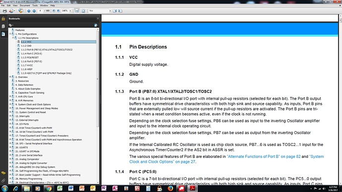

All you have to do is open the 660 page datasheet with Adobe reader and select chapter 1.1 Pin Descriptionss under which the first item is 1.1.1 Vcc, which is described as "Digital Supply Voltage",
which , can in no way be confused with "Unregulated Voltage"
DATASHEET
