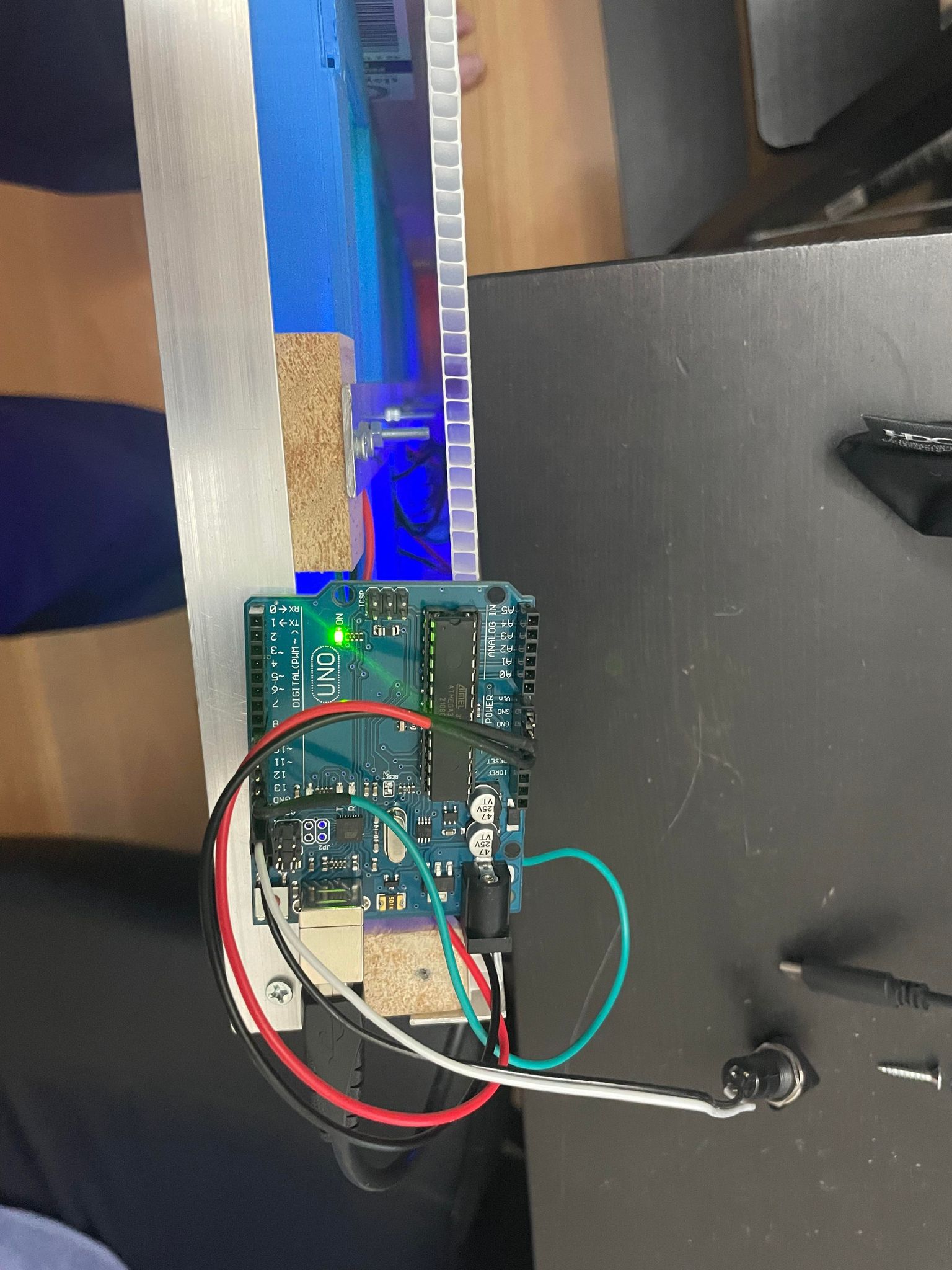

I have created a 6-digit 7 segment display using a string of 2812 LEDs. I have taken code from projects that have 4 digits.
I am battling to achieve an end point for this project. all the hardware works well and lights are fine. Im trying to get some help with the coding to create a stopwatch that counts up from zero
there are 168 addressable LED all connected together. i dont need a RTC however it would be nice add.
Any help would be appreciated.

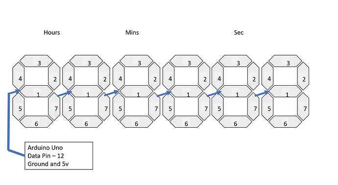

Segements are as follows (tried drawing with 4 LED per segment but forum didnt like the post
.....3.....
4.........2
......1....
5.........7
....6.....
Is that diagram a variant of the standard 7 segment labelling pattern:
Anyway, how far have you got ? Show a schematic and show a simple example sketch where you light one segment, say the top segment of the first digit.
EDIT
I guess if you have 168 addressable positions and you have 6 digits each made up of seven segments and each segment consists of 4 of the addressable leds, the first step is to devise a structure to represent the whole display. Maybe a 3 dimensional array such as uint8_t digit [6] [7] [4]
where the first dimension is the digit position 0 to 5, the second dimension is the segment number 0 to 6 and the third dimension is the four addresses of the leds which make up the segment.
I have tried to do this:
as a new user i cant upload attachments - segment points are when referencing your image.
G=1, B=2, A=3, F=4, E=5, D=6, C=7
HH:MM.SS
hours are first digits in line.
you are correct with the number of lights per segments

You tell something works and LEDs are shining. As already requested, schematics would be helpful but especially the code. Most helpers don't have chrystal balls.
Hi, @gingergod
Welcome to the forum.
Your code and schematic would make this a whole lot easier.
@TomGeorge thanks for the direction.
I believe that i have uploaded both a pic of the schematic and the code that i have gotten to currently (borrowed from a source with some edits.

#define NUM_LEDS 168
// The pin which is connected to the DataIn of the LED strip
#define DATA_PIN 12
// If defined, timer shows minutes and seconds MM:SS, rather than seconds SSSS
#define DISPLAY_HHMMSS
You say you only see 4 digits, right? And you want 6, right? Well, then you have to program that extra 2 digits here:
  // Display as mm:ss
  #ifdef DISPLAY_MMSS
    // Use modulo to calculate "remainder" seconds
    int seconds = (timeValue / 1000) % 60;
    int minutes = timeValue / 60000;
    // Units
    setDigit(3, seconds%10, CHSV(timeHue, 255, 255));
    // Tens
    setDigit(2,(seconds/10)%10, CHSV(timeHue, 255, 255));
    // Hundreds
    setDigit(1, minutes%10, CHSV(timeHue, 255, 255));
    // Thousands
    setDigit(0,(minutes/10)%10, CHSV(timeHue, 255, 255));
  // Display in seconds
  #else
    // Units
    setDigit(3, (timeValue / 1000) % 10, CHSV(timeHue, 255, 255));
    // Tens
    setDigit(2, (timeValue / 10000) % 10, CHSV(timeHue, 255, 255));
    // Hundreds
    setDigit(1, (timeValue / 100000) % 10, CHSV(timeHue, 255, 255));
    // Thousands
    setDigit(0, (timeValue / 1000000) % 10, CHSV(timeHue, 255, 255));
  #endif
Something like:
setDigit(4,(timeValue/100)%10,CHSV(timeHue,255,255));
etc..
6 digits light up now thanks so much - this is the new code
once i upload top the board it will DC from pc almost instantly
  // Display as mm:ss
  #ifdef DISPLAY_MMSS
    int hours = (timeValue / 3,600,000);
    // Units
    setDigit(5, seconds%10, CHSV(timeHue, 255, 255));
    // Tens
    setDigit(4,(seconds/10)%10, CHSV(timeHue, 255, 255));
    // Hundreds
    setDigit(3, minutes%10, CHSV(timeHue, 255, 255));
    // Thousands
    setDigit(2,(minutes/10)%10, CHSV(timeHue, 255, 255));
     // Hundreds
    setDigit(1, hours%10, CHSV(timeHue, 255, 255));
    // Thousands
    setDigit(0,(hours/10)%10, CHSV(timeHue, 255, 255));
  #else
    // Units
    setDigit(5, (timeValue / 1000) % 10, CHSV(timeHue, 255, 255));
    // Tens
    setDigit(4, (timeValue / 10000) % 10, CHSV(timeHue, 255, 255));
    // Hundreds
    setDigit(3, (timeValue / 100000) % 10, CHSV(timeHue, 255, 255));
    // Thousands
    setDigit(2, (timeValue / 1000000) % 10, CHSV(timeHue, 255, 255));
    // Thousands
  #endif
  // Send the updated values to the LED strip
  FastLED.show();
  delay(20);
