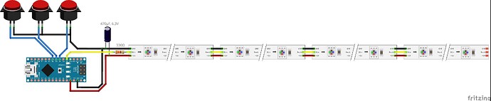

Button to cycle through numbers in a 7 segment clock
I've been handed a 7-segment display with 4 digits that use a LED stripe for the segments. It was originally used as a stopwatch/timer at a school. The original maker passed away so it was handed to me to modify but I haven't coded anything in years so I'm really rusty. I've mashed together some codes but it's not working. I just want it to start with 0000 then 0550,1250,3050,5000 then back to 0000 and have them be able to start over again.

Hi, @krunchee
Welcome to the forum.
Can you please post a schematic?
An image of a hand drawn schematic will be fine, include ALL power supplies, component names and pin labels.
What are the pinouts on the display?
You have told us what you want the code to do, now tell us what it is doing?
A picture of your project would be good too.
I think "doesn't work" means "does not compile".
When code does not compile, you should explain that and post the complete list of error messages inside code tags.
When you say "does not work" everyone will assume that the code compiles and uploads but does not behave as desired
You tried to define functions inside another function (loop() in this case) and that's not allowed in C.
Try this

Here is the layout it uses a Nano Board CH 340/ATmega+328P
I moved sections around and I get fewer compile errors now.
