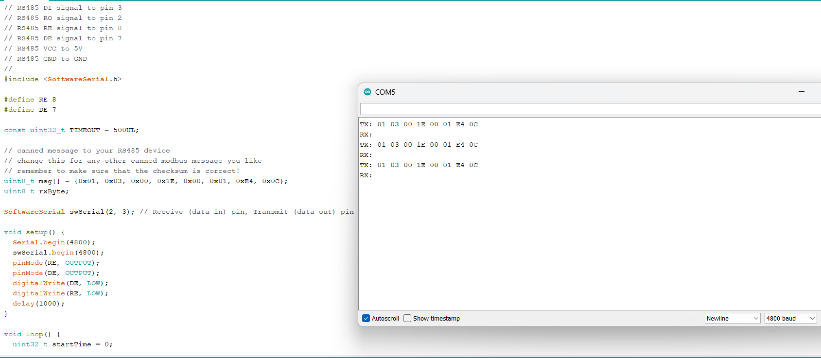

Re your post #8, if you are using the code that I provided in that post, the a quick baud rate change should work:

Then you should get a reply if wired as per your image in post #1. Make sure that you have a GND between the Arduino, MAX485 module and the sensor.
Check that you have your A & B the right way round - try swapping them over just in case.
EDIT: I'm beginning to suspect that the datasheet you have been given does not match the sensor you have.
I tried the program that you wrote again and changed the baudrate as you mentioned and unfortunately, the serial output is still the same. I also tried swapping the A & B wires but it's still the same.
I also tried changing the two baudrates but it's still gives the same output.
Don't worry about the baud rate of the Serial.begin function call - that's to do with communicating with the IDE.

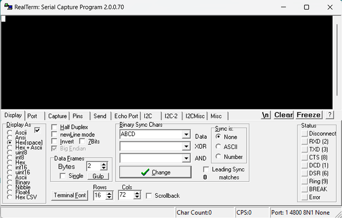

Ok, now it's time for some detective work. When you used your PC app, you had a USB-RS485 dongle. We can use that same dongle to see what's happening with your Arduino setup.
If you don't have it already, download RealTerm - it's free. There's a nice writeup on the Sparkfun website about it here.
With your sensor, your MAX485 board and your Arduino all connected up, plug your USB dongle into your PC and connect its A & B wires to the A & B wires of the MAX485 board - and GND as well if the dongle has one.
Open up RealTerm, set the Com port for the USB-RS485 dongle and the baud rate to 4800. See the Sparkfun writeup for details on how to do this.
Also look at the section "Adjusting the Display" and set it to Hex [space].
With your Arduino code running, you should see data being displayed by RealTerm.
I have done everything that you said and connected my USB-RS485 to the sensor, arduino, and max485. After setting up the settings in the said website which can be seen in this screenshot.
Will there be an automatic output in the Realterm software or I need to manually input the values? because as you can see, the arduino code is already running and nothing is happening to the Realterm Software.
Ok. If you see nothing in the Realterm window, the that suggests that there is a problem with the transmission of the message from the Arduino.

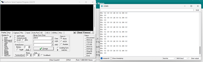

I would head straight for AltSoftSerial. This a modified, but untested, version of my previous test code that uses AltSoftSerial:

With AltSoftSerial, you have to use pins 8 & 9 - you can't choose like you could with SoftwareSerial. I had to move RE to pin 6 as pin 8 is needed by AltSoftSerial.
See if you get anything displayed at all in Realterm.
If you get nothing displayed, then we can go back to real basics and join pin 8 to pin 9 on the Arduino. The Arduino will essentially be talking to itself and the IDE should show an RX message exactly the same as the TX message.

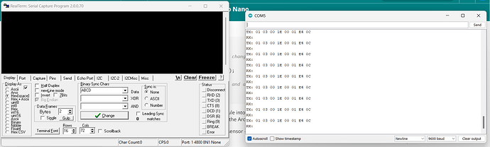

There's still nothing on the Realterm software. On the other hand there is now a single reply of 00 in the RX which you can see in this screenshot:

Unfortunately it doesn't send the TX back to the RX. I already disconnected the sensor and attached the A & B Pins of the dongle to the MAX485. This is the result from your updated code:

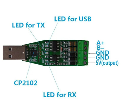

FYI also, this is the USB-RS485 that I am using
I've connected the A & B Pins to the A & B of the MAX485 and connected one of the GND pins to the common ground of the components.
This is beginning to sound like the MAX485 board isn't working.
We know that the Arduino can talk to itself. When we introduce the MAX485 board, it doesn't appear to want to transmit any data. That would explain why you don't see anything in Realterm and why your sensor doesn't respond.

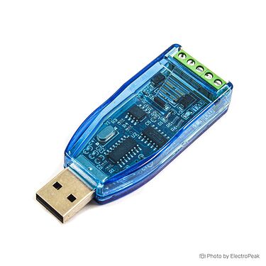

I have a similar USB-RS485 dongle although mine is in a translucent case.
We know that your USB-RS485 dongle is working as your PC program can talk to the sensor. It's a useful tool to have especially when trying to figure out problems like this.

That code should result in you seeing something in Realterm. You shouldn't see an RX message in the Arduino IDE as you don't have the sensor connected (do you?), and I don't think you can do an RS485 loopback test with that module.
All the RE & DE pin manipulation code can stay - there's nowhere to connect those pins to on your auto switching board.
The main test is whether you see anything in Realterm that would indicate that the Arduino & RS485 module are working together to transmit the test message.
