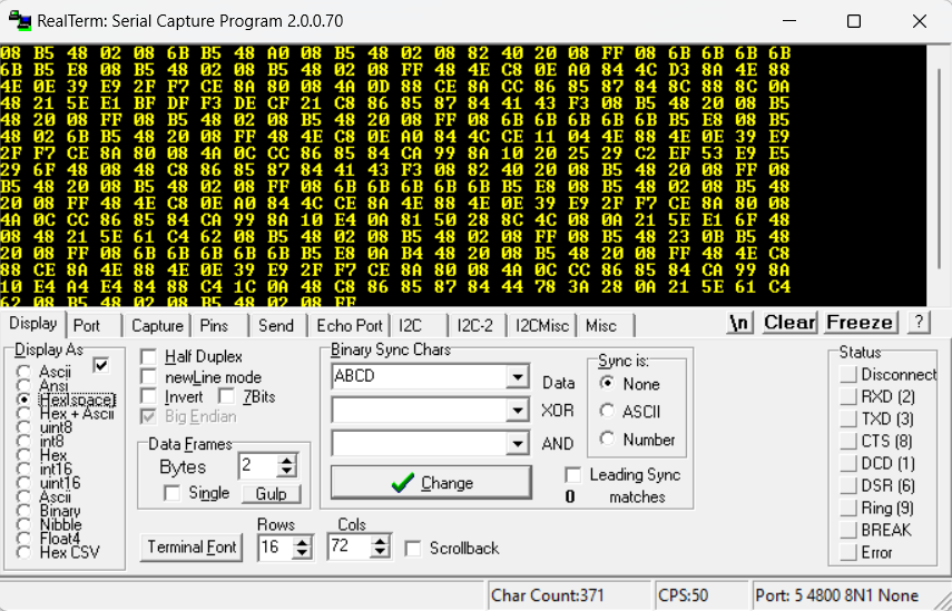

Hello. I tried the Realterm again, this time I selected the port which is where the arduino nano is connected and I got this response from the Realterm Software.
The connections are the RS485 module and the USB dongle to the arduino just like last night. But when I switch to the port where the USB dongle is connected, nothing displays in the Realterm.

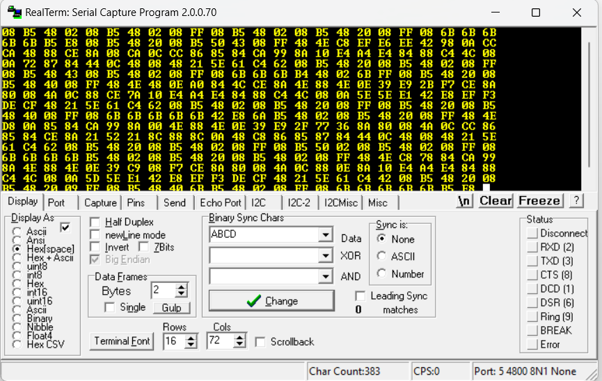

EDIT: I tried to run Realterm together with the sensor and I run the code which measures all the parameters mentioned in post #11 and here is the response from Realterm. Again I choose the port where the arduino nano is connected which is COM 5.
But the values returned in the Serial Monitor of the Arduino IDE is still the same

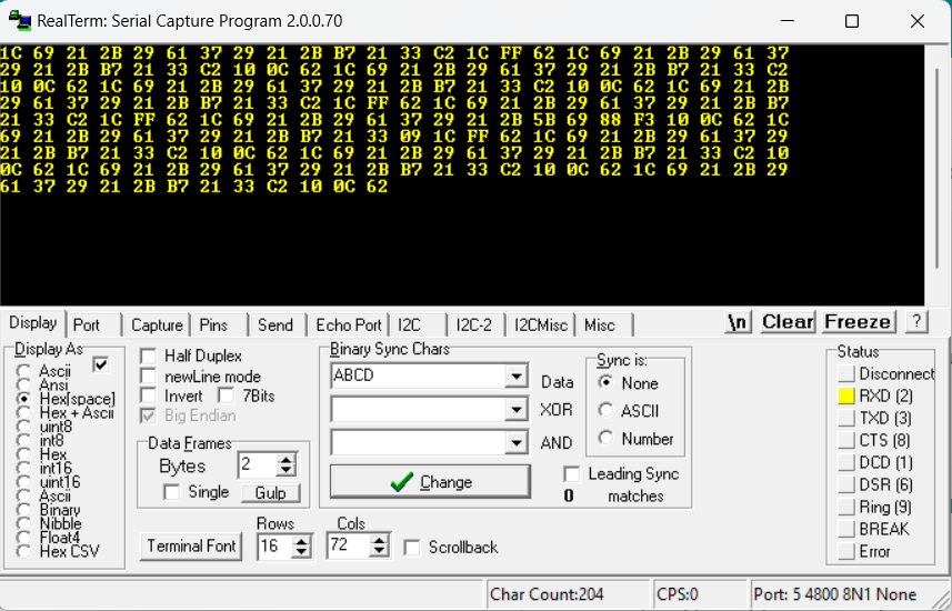

I also tried the suspected broken MAX485 module together with the sensor and Arduino. After running the code. I checked the Realterm software and choose port 5 which is where the Arduino is connected then I also got a response in Realterm.
And after checking the Serial Monitor, the outputs are still the same as the response in post #50
That would be the sort of data I would expect to see. You are seeing Realterm trying to interpret the serial output that you saw on the IDE serial monitor. Realterm is showing it like that because the software was configured for 9600 baud on the hardware serial port and Realterm is set for 4800 baud.

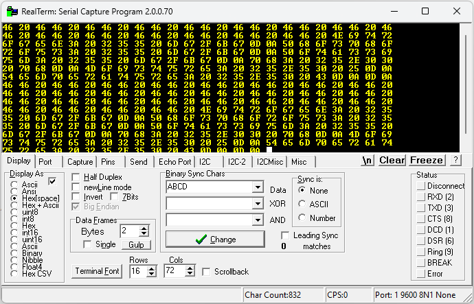

Are you saying that I should change the Realterm's baudrate to 9600?
Another side note. Do you think that the processor is one of the reasons to why I'm not able to get the message that I am sending because I am using the Atmega328P (Old Bootloader) because when I'm using the latest Atmega328P processor there's always an error which says that it "cant't set com-state" for the port. The wrap around that I did is that I downgraded my USB port driver an used the "Old Bootloader" and that is when I can upload my sketches to my nano.
I ran the sketch again using the auto switching module but this time I changed the baudrate of the Realterm to 9600 and here are the results that I got.
That looks about right. Those are the ASCII codes for the characters that the IDE would normally show you. You can see the real text by selecting display as ASCII.

Here are the response when I changed the display to ASCII:
It seems that it's the same to the output in the serial monitor on the IDE
