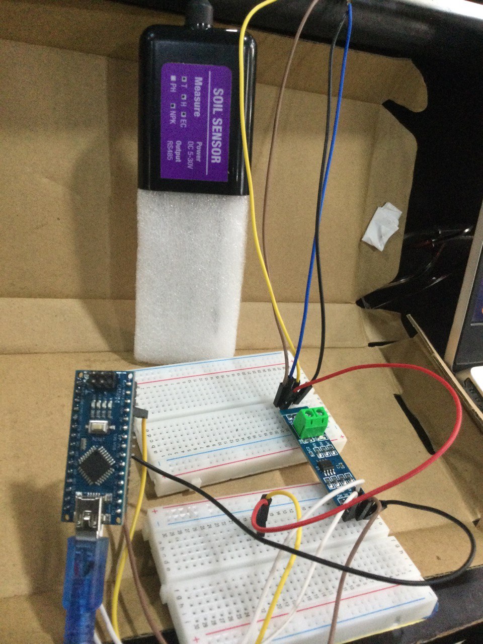

  • Which Arduino do you have? Arduino Nano
  • Which RS485 module are you using? Max 485 TTL To Rs-485 Interface Module
  • How have you connected the Arduino, RS485 module and sensor together? Can you provide a drawing - hand drawn and photographed is fine.
  • How are you powering your sensor? I intend to use a battery once i solder but for now its still via by arduino connected to my PC
    [/quote]
Sorry, I have no idea where the wires are going based on that photograph.

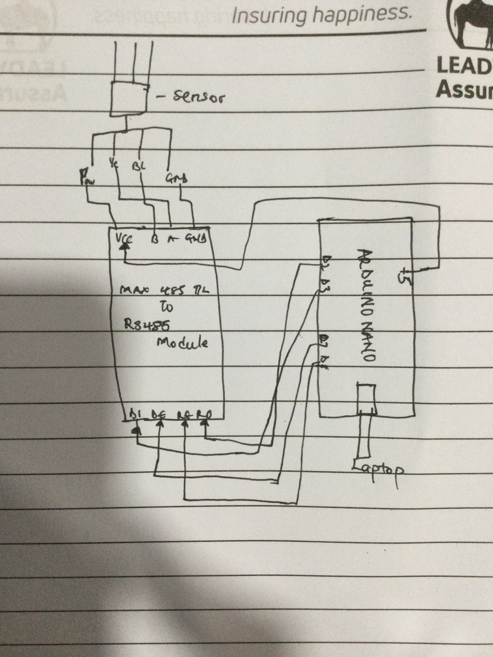

Alright. I'll send in a hand drawn circuit diagram

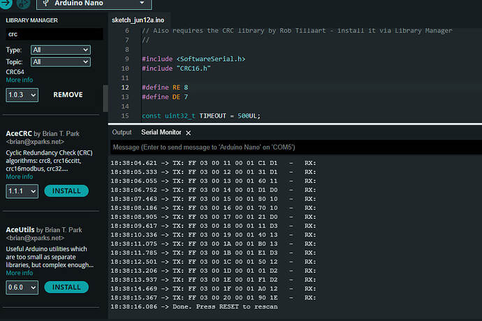

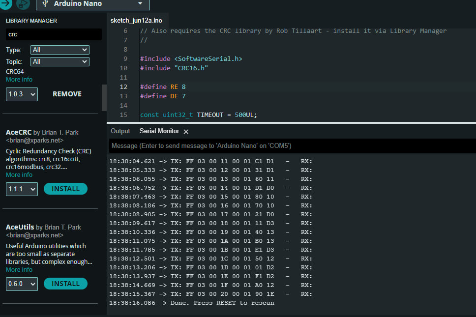

Also, I tried the code you sent in,
and I got this result.
If you didn't see anything displayed next to RX: on any line, then your sensor isn't responding at all. Hopefully it will be a simple wiring problem.
Ok. A few points:
  • It's not generally a good idea to power other devices from the 5V pin on the Arduino - you can probably power the RS485 module but I would power the sensor from another source
  • 5V is at the bottom end of the range of voltages that the sensor can be powered from (but I would think it should work from 5V)
  • You need a connection between the GND of the RS485 module and the GND of the Arduino.
  • Make sure that the pins you are using for RE & DE are the same as what your code is using.
Thank you. I'll check the wires for continuity and use a different source for the power supply
I just checked the wires and found some faulty wires. Then got this output on the serial monitor. I also used a different power source for the sensor.
I'm getting a value for the RX now
08:33:04.595 -> TX: 01 03 00 0A 00 01 A4 08 - RX: FF 08:33:05.322 -> TX: 01 03 00 0B 00 01 F5 C8 - RX: 08:33:06.032 -> TX: 01 03 00 0C 00 01 44 09 - RX: FF 08:33:06.781 -> TX: 01 03 00 0D 00 01 15 C9 - RX: 08:33:07.469 -> TX: 01 03 00 0E 00 01 E5 C9 - RX: 08:33:08.223 -> TX: 01 03 00 0F 00 01 B4 09 - RX: FF 08:33:08.913 -> TX: 01 03 00 10 00 01 85 CF - RX: 08:33:09.647 -> TX: 01 03 00 11 00 01 D4 0F - RX: FF 08:33:10.341 -> TX: 01 03 00 12 00 01 24 0F - RX: FF 08:33:11.060 -> TX: 01 03 00 13 00 01 75 CF - RX: 08:33:11.779 -> TX: 01 03 00 14 00 01 C4 0E - RX: FF
Also, I have been able to get the sensor manual from the seller. Since I'm a new user I'm unable to post an attachment.
It doesn't look like the sensor is responding at all. Make sure RE & DE are connected correctly and your RO & DI go to the correct pins too.
Look in your user manual to see if it mentions baud rate. It'll probably be 9600 or sometimes 4800. You should set your software serial port to that setting.
